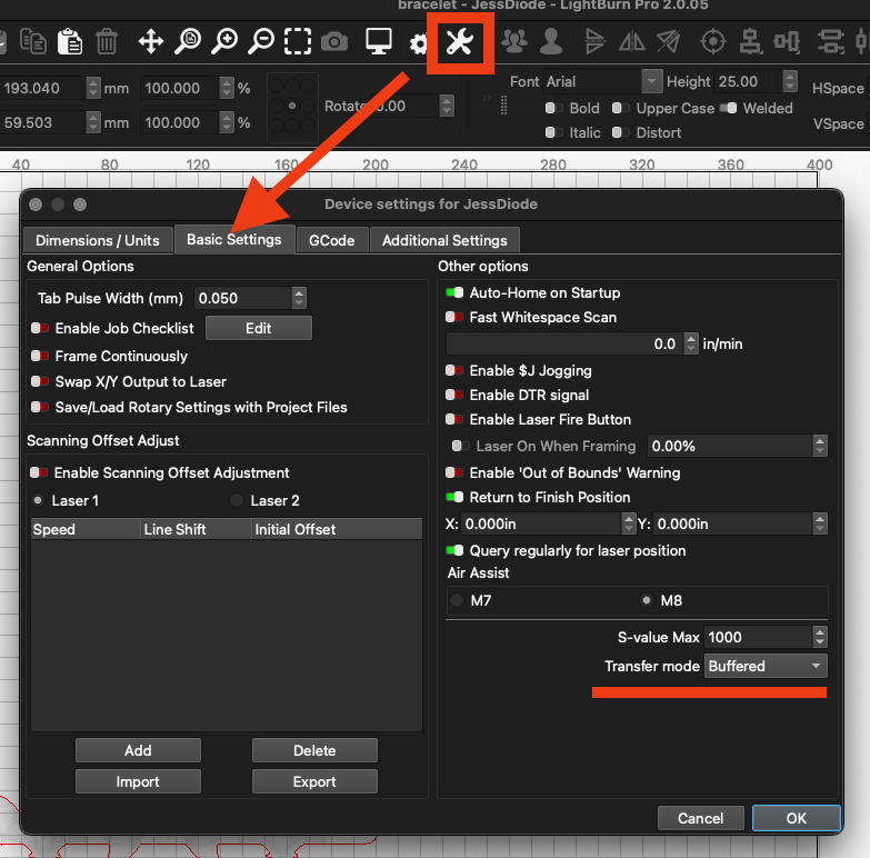

I think in device settings there is an option for the serial communication for setting it to buffered or synchronized or so. You might try to change it, no matter what it is now set to. Worth a try.

That’s an easy fix you have a corrupt download for some reason. Sounds like a Windows process. All you need to do is totally uninstall and reinstall the program that will fix your issue.
I’m not at my pc right now, but it’s next to the baud rate setting.
The serial communications setting is referred to as the transfer mode in our documentation:

Yes, Jessen, that’s all I could find in the Devices panel. Bottom right under Air Assist called Transfer Mode. Options are Buffered and Synchronous. Mine is set to Buffered. I’ll try changing to Synchronous, then later change it back to see if that fixes it.
