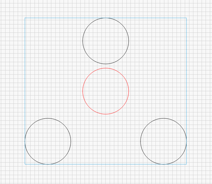

I can’t reproduce this given your steps. I also don’t get a different behavior with the workaround method.
Could this be because you’re expecting the “center” of the result of the array to be centered on a figurative circle around the array rather than as a rectangle of the resulting 3 shapes? Note that the center of a selection rectangle for 3 even spaced shapes is not necessarily equidistant from the center of each shape.
Review the following:
  1. the black circles are even spaced apart
  2. the blue rectangle represents the selection area of a group of the 3 black circles
  3. the red circle is the geometric center of the rectangle
  4. the red circle is not equidistant to the center of each black circle
  5. all of these statements are true concurrently

In general, I see your point that a 3 (or odd#) object circular array, enclosed by a selection box, and centered will not result in each object’s center being equidistant to the centering point.
Hopefully you saw that when you tried reproducing the (supposed) problem I reported :slightly_smiling_face:
It was a surprising result for me, since I was so use to the object array always being perfectly centered. I guess I just had never used the tool to create an odd number of objects in the array.
Anyway… for anyone trying to get an odd number of array objects centered, I think my workaround should be helpful (i.e., since just doubling the Odd# of objects will always yield an Even#, which should center properly).

I think this was just luck because you are have an even number of sides in the bounding box. Had you used a triangle for the bounding box (odd # sides), it would have centered as you expected. Had you used a circle for the bounding object (infinite sides), any number of circles would have centered like you expected.
