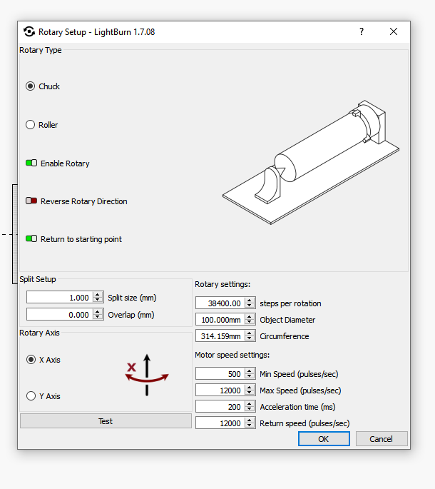

So Here is the problem condensed down to as few examples as possible.

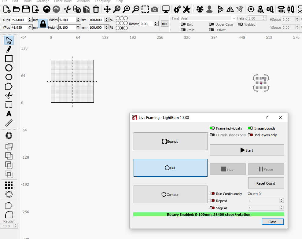

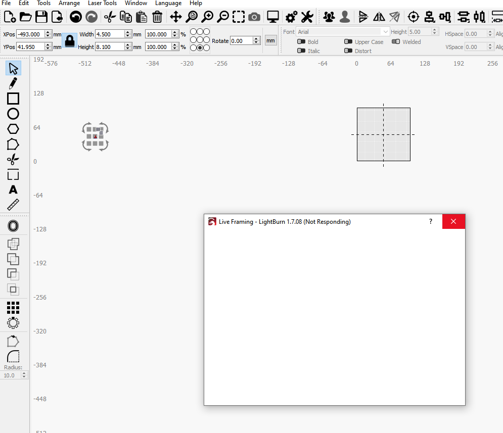

Using rotary, example diameter 100mm circumference 314.159mm I can place an object greater then X:314.159 and frame, say X=493, burn. BUT, I can’t move that same object to X=(-)493, framing freezes.

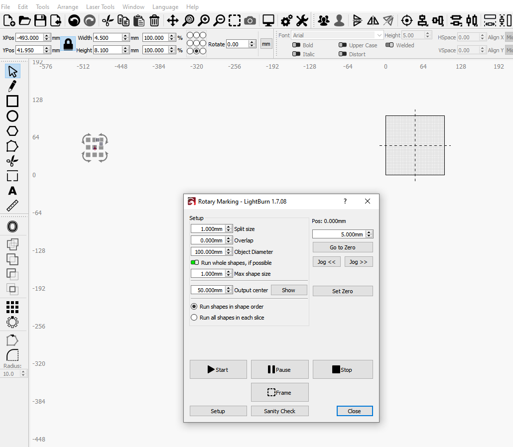

BUT, I can skip framing and then it will work.

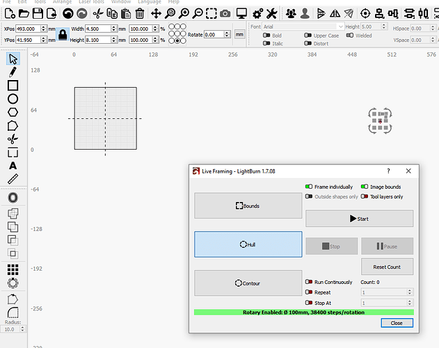

493 Positive X, Works fine
493, Negative X, Freezes

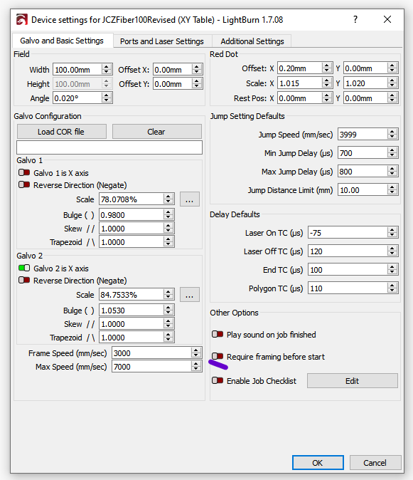

Negative X, Require Framing “OFF” Works if jumping right in with the “Start” button.
Rotary settings
