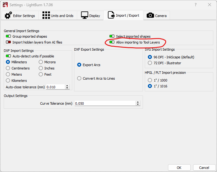

Bug: svg imports to wrong layer
Bug: The svg file below contains a single rectangle with rgb color (243, 105, 38). Per the layer colors this should import to layer T1. However it is importing to layer 05, which is the closest non-tool layer. The svg displays as a picture and not a link to a svg file so… I assume you can right click the orange square and click “save as”.
I am on Windows 10, LightBurn 2.0.05.

Do you have this option enabled?
SVG files definitely specify object colors. Most of the files intended for laser cutting use black, probably because it looks like charred wood. :grin:
@Marcus_Wakefield I did not have that option enabled, and enabling it was the solution. For others on the internet, the option is located at “Edit“ → “Settings” → “Import/Export“ tab → “Allow importing to Tool Layers“.
