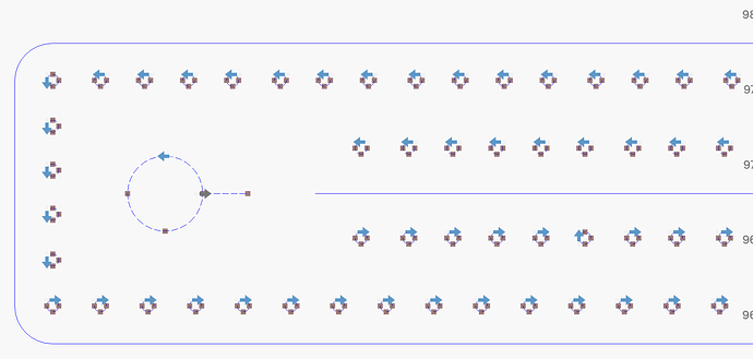

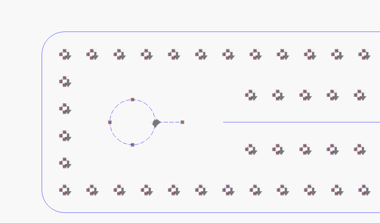

Unoptimized path:
Optimized path:

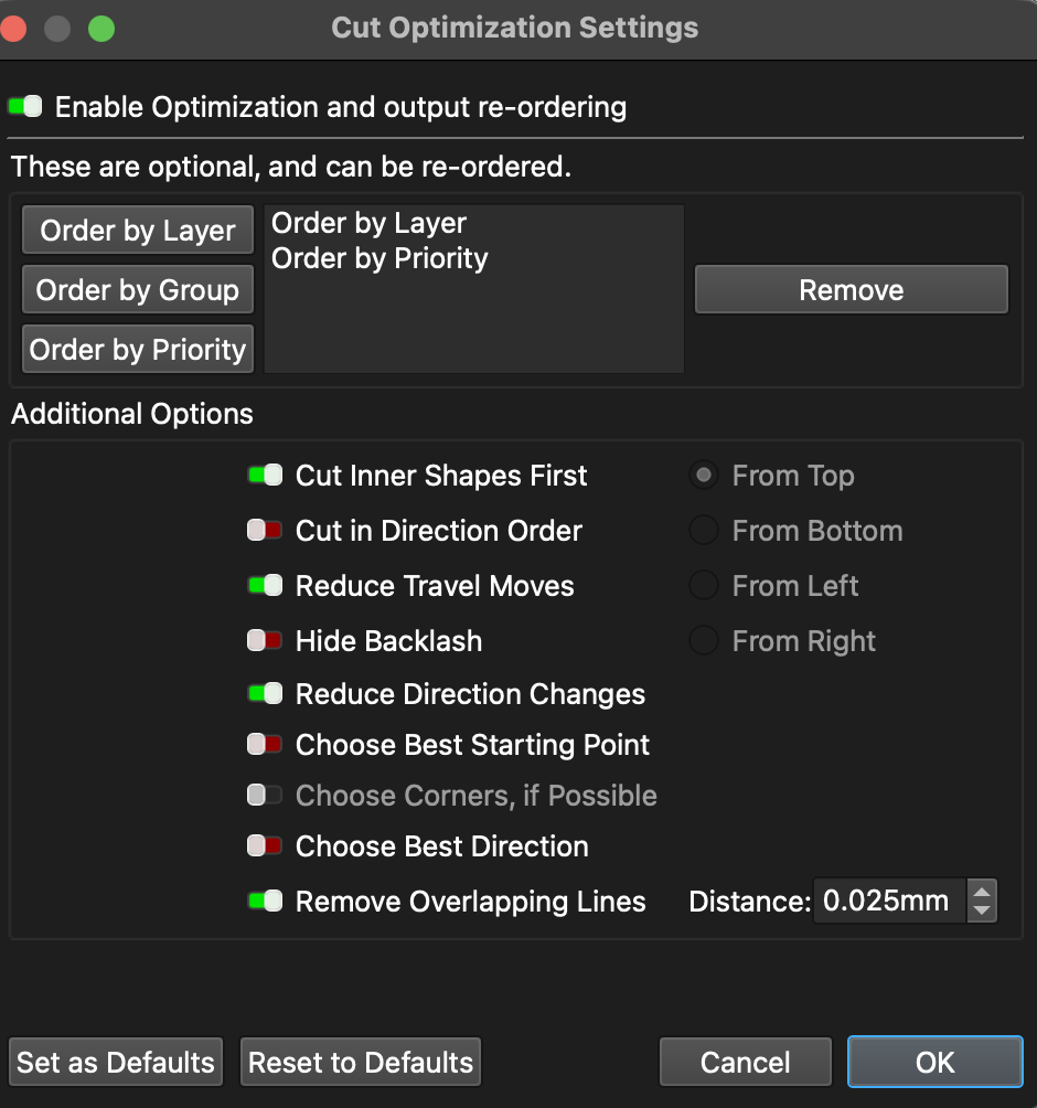

In both cases when running the full design with this optimization settings:
At 18mm/s with an Y accel of 2500 mm/s and a X accel of 5000 mm/s and the avg. size of the circle at 0.8mm I get around 3 mins less every time I run the file which may not sound like much, but over the same design being run over and over again it quickly adds up (I have to run it around 100 times every time I work on that design)
if I use “best starting point or best direction” in any combination it either takes more time as not having those or a couple seconds less, so no dramatic improvement there.

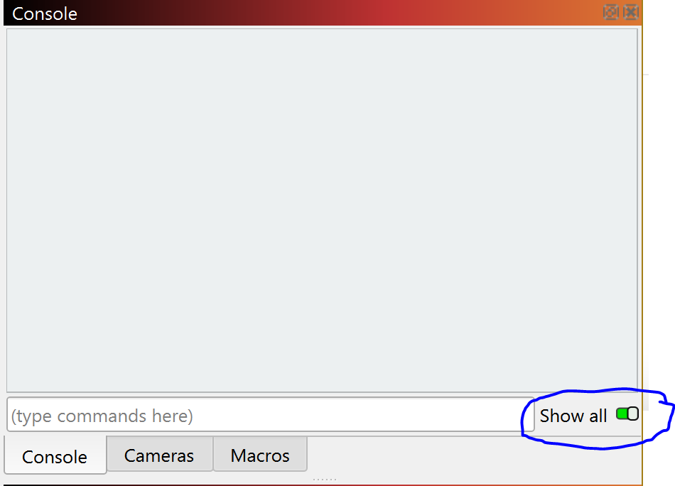

As a start type $$ in Console Window then copy and past here the output.

Sorry, didn’t see the email for this one, I can’t share the full designs because I’m not allowed to… BUT here’s a bare minimum reflecting the basic idea from the screenshots, I’ll get the the console output when I get home
bare min holes.lbrn2 (43.6 KB)
Normally designs would be something like that but repeated N amount of times, or circles like that but following some natural flowing shapes

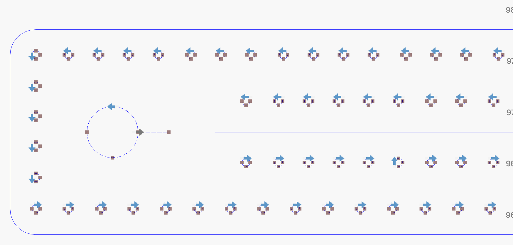

Sorry for the late reply, I did some simulation metrics with your project file:
Original file:
Without optimizations
With proposed optimization
With Shapes Start point “optimized” and proposed Optimization Settings
Given the results above, I´m forced to conclude that there is no real gain between manual optimizations and Lightburn´s optimizations in the above project.
Of course the results are influenced by the Simulation Settings and the real values are also influenced by your laser GRBL settings. .
This looks like a perfect example of Amdahl’s Law:
the overall performance improvement gained by optimizing a single part of a system is limited by the fraction of time that the improved part is actually used
Because the Line = cut speed is 18 mm/s (which will likely never be reached in those tiny circles), that’s where the machine spends nearly all of its time:
LightBurn - Cut vs transit times
If you could eliminate all the time spent moving between holes, the elapsed time would drop by only 13 seconds = 17%.
Given the relatively small distances between the holes, the machine cannot reach whatever the non-cutting maximum speed might be, but the cuts will still dominate the overall time.
