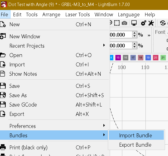

If you point to your *.lbzip file :
Hello, I exported my bundle to my USB and then uploaded the files and imported on my new computer but nothing imported. I know I must be missing a step.

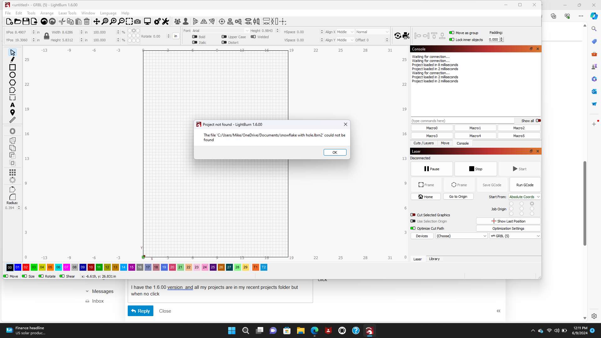

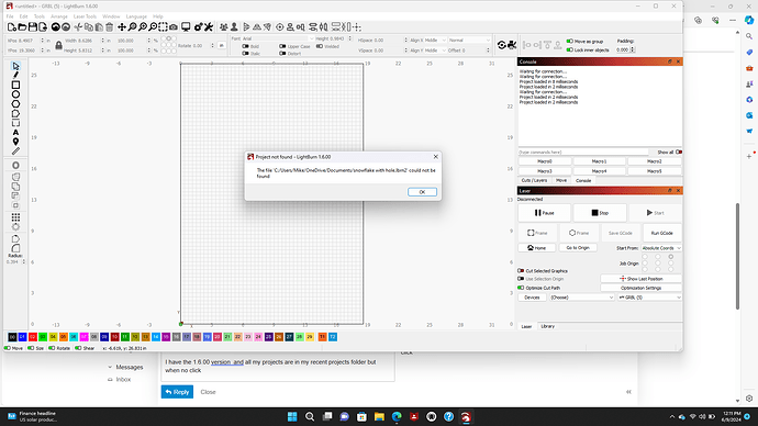

I have the 1.6.00 version and all my projects are in my recent projects folder but when I click
but they all say file not found. The odd thing was I already had to transferred to another computer previously performing more steps and had no problem, this new easier method has created me more problems. lol I have looked everywhere for those files

The project files on your old computer are not part of the bundle system. LightBurn will bundle up preferences, art library and material library files, but it has very limited knowledge of your project files, so those are your responsibility to move.

Like Oz said above, project files don’t transfer with the bundle feature. You need to manually move them to your new computer or navigate to whatever network location they are at.
The reason your recent projects show as not found is because the path to them is not the same on your new computer as it was on your old computer.
Hello, I did export my bundle from the old computer and then imported to my new computer but I can find no files anywhere?
You keep saying the same thing: You copied the bundle to your new computer.
We understand this, however the bundle does not include any project files.

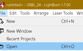

You will need to copy those to a suitable location on the new computer, then open them NOT using the “recent files” entries, but using File > Open and manually browsing to the location you saved the files on the new computer.
