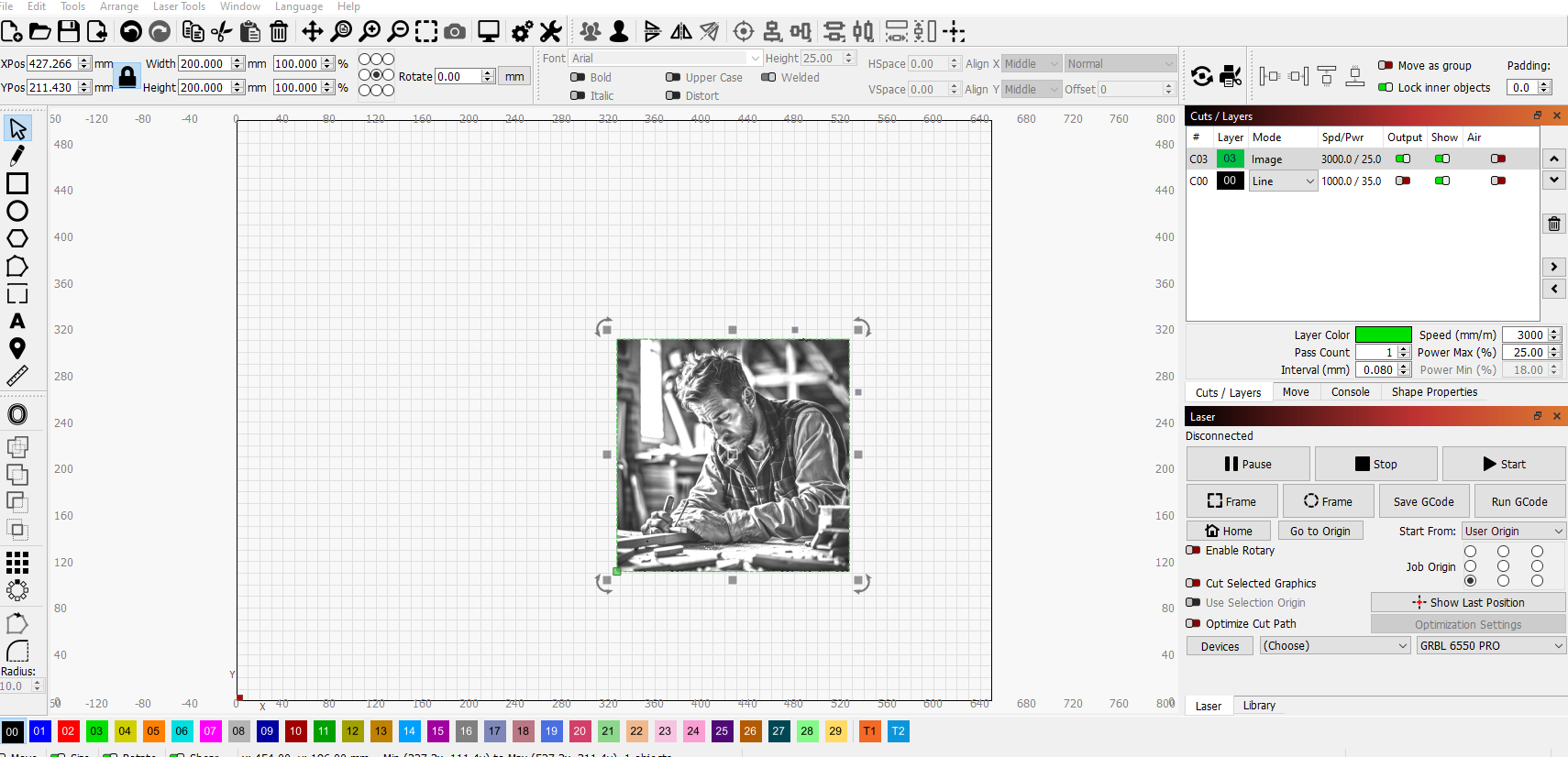

Hi have found that when I set the origin to the corner of my tile engraving it always starts about 4-5mm in the X and Y position from where I nominated User Origin position. I have a Yorahome 6550 PRO. Have checked my $ settings and G# codes and can’t find anything that is showing this offset. I have looked through the Lightburn settings and can’t find anything in an offset, is there a setting I should be checking? Is there some way I can set up a permanent allowance for this in GET Position etc. or is there another way

  1. If using Absolute Coords do burns occur where expected?
  2. For this issue, can you take a full screenshot of LightBurn with the design loaded and ready to go?
  3. What coordinates have you set User Origin to?

The design setup looks fine to me. I don’t see any obvious issues there.

I’m curious. What does the Line layer look like? It’s not obvious from the screenshot.
If you enable “Cut Selected Graphics” and “Use selection origin” does it resolve the issue?
The line layer is a square snapped to the size of the picture. I have zoomed right in, and it does not overshoot the photo. I add this to insert the photo to size I want. Besides that it is on another layer that doesn’t output.

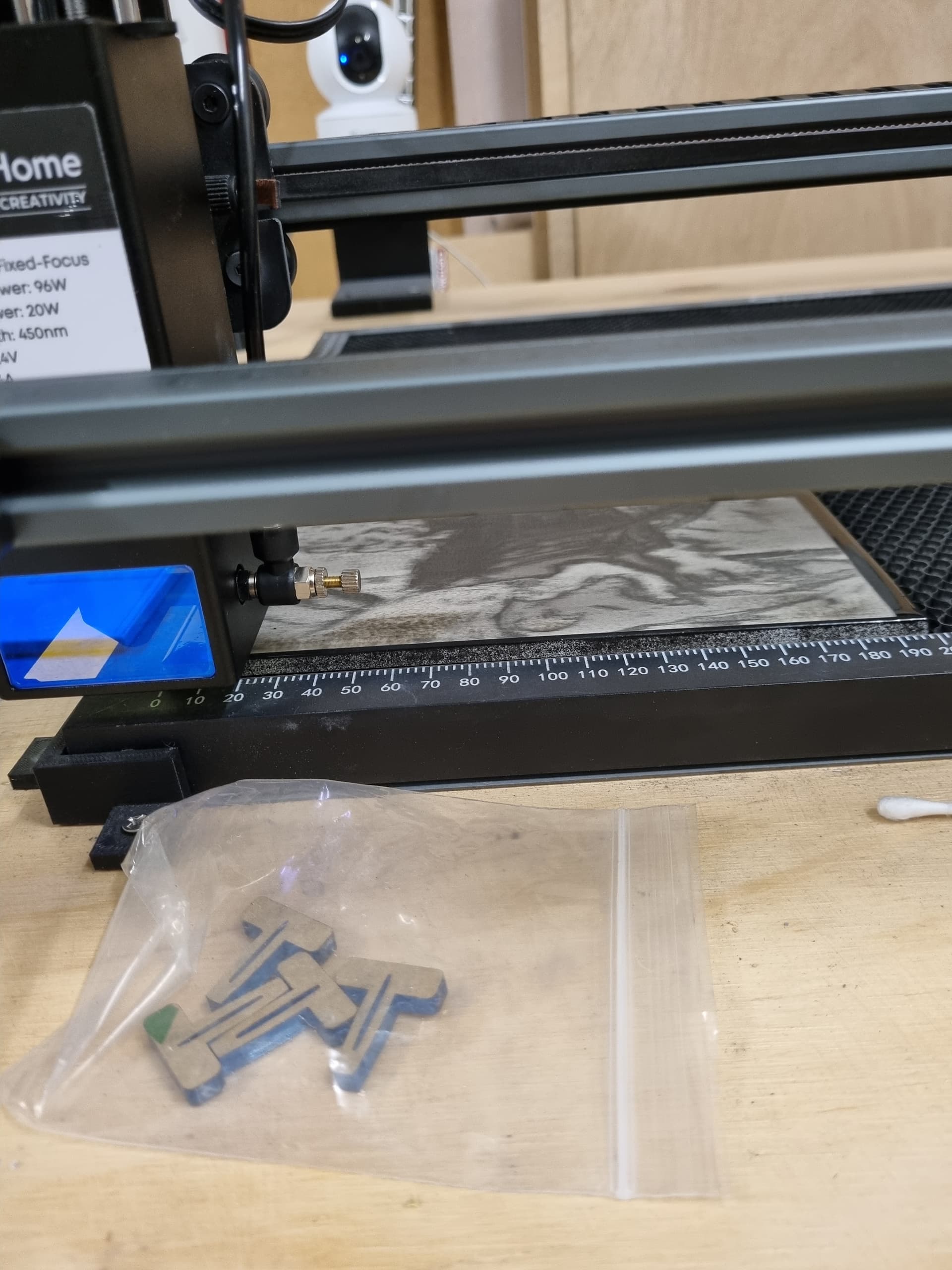

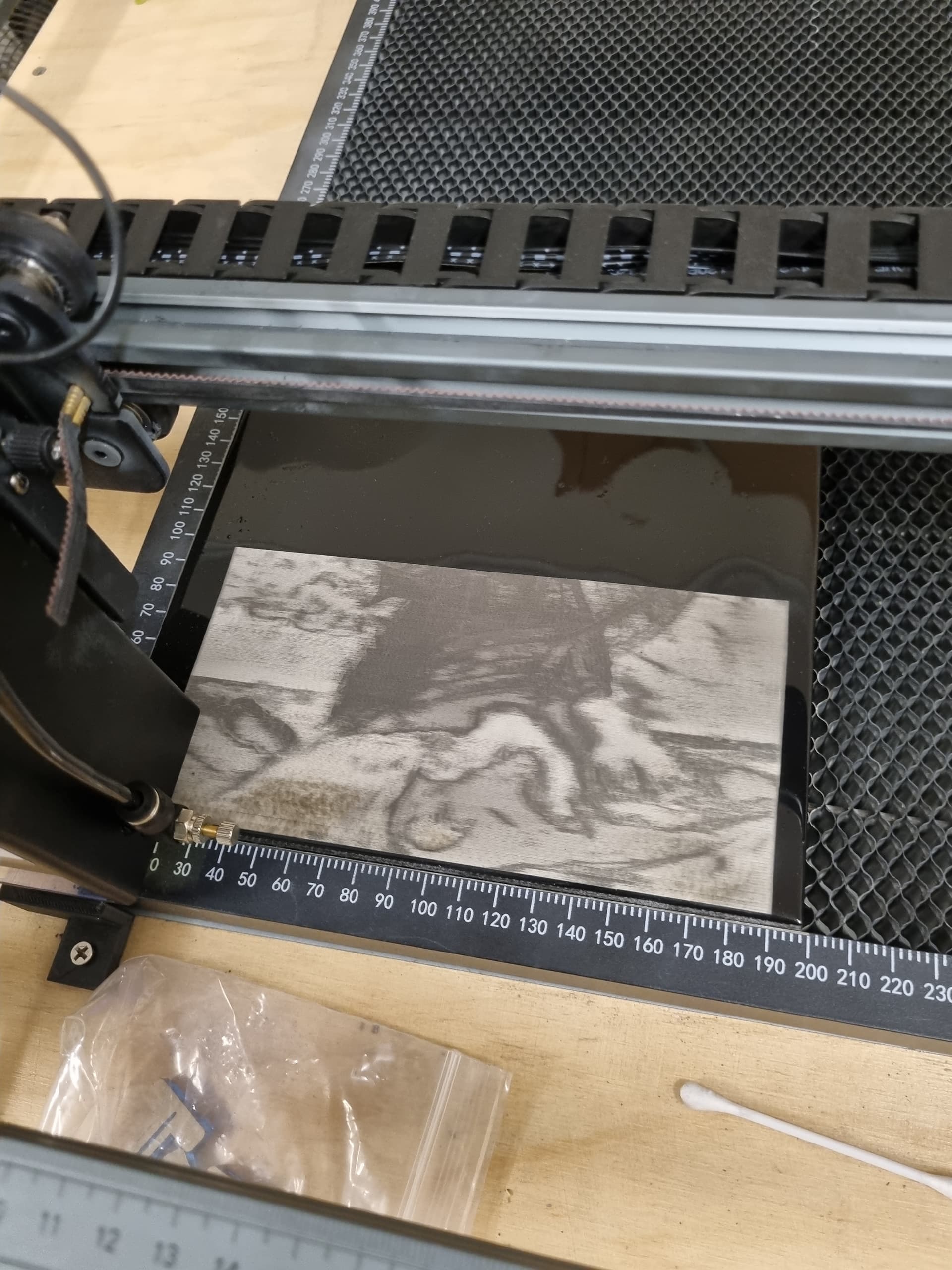

The photo is not the same size as the tile. I have to centre the photo on the tile. The photo I have just started is 200mm x 170mm and the tile is 200mm x 200m if that explains it. I am in the middle of a burn right now to complete what I had setup new, so will get back to you with a photo once the engrave has finished as well as the $$ settings
What’s your process for doing this in this example?
Have set 0,0 as the corner of the tile as usual as I also tried cut selected graphics but it didn’t start correctly either even though I set the 0,0 origin in the desired distance to centre the picture. It also moved 5mm in both directions as well from the origin when started. So I am engraving with the setting origin as the corner of the tile. Yorahome has got back to me and said that there is nothing in the firmware that would affect the startup and change of position that I am experiencing.
As you can see in the photos the margin on the side of the tile each side is different whereas they were set equal in Lightburn and moved 5mm in when the start button was pressed
