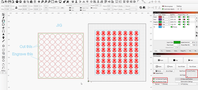

That’s a quite easy task. I described the process here (section mass production):
You just need to engrave a square around the holes in your template, which you can use to reference the laser position afterward. Use “current position”, “cut selected graphics only” and “use selection origin” as settings in laser window. Put the square on a tool layer which is also set to “frame”. Then you can frame until you placed the jig perfectly in the workspace (doesn’t matter where) and fire up the laser.

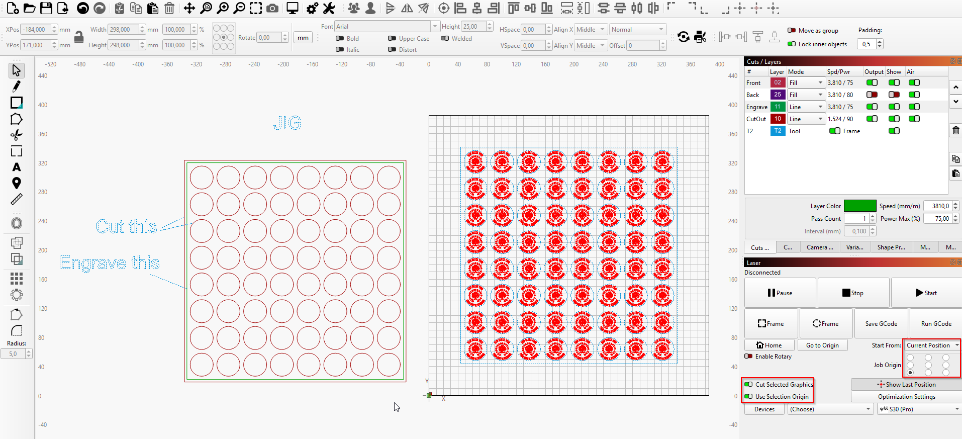

I got interested in this and checked out the LB file. I went through and made some changes that I would apply if I had this project. I did not change any power or speed settings, but I did manage to cut the project time a lot. The Notes explains the project flow.
I hope I did not overstep my bounds here, but I could not resist trying to help.
The Way, The Truth & The Life coin - Edited.lbrn2 (3.6 MB)

Compare the run times between your file and mine. You will see a big difference. When you have a 5w or 10w laser, optimizing (fiddling with the settings) and checking it with Preview can really help. I consider Preview as probably the single most important tool in Lightburn.

Here is how I’d do it. First, cut the jig. The jig then has all the cutouts and an engraved square around them.
The next step is to select all engravings AND the square (on tool layer) around them. Set the options as depicted in the laser window. Then move the laser head to the lower left corner of the engraved square on your jig. Do a frame to check if the laser travels along the formerly engraved path. If so, start the job. Otherwise, reposition the head or the jig. You can even move the jig while the laser is travelling; this will save some time.
The Way, The Truth & The Life coin - Edited.lbrn2 (3.5 MB) (Edited the version of Mike again :slight_smile: )
Supposed to change the filename slightly. :nerd_face:
My version was based on using a 12"^2 sheet of 3mm Baltic ply to make the actual coins. Then using the scrap with the holes as the fixture for engraving the back.
