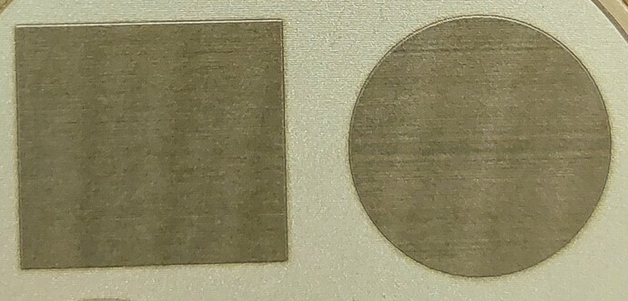

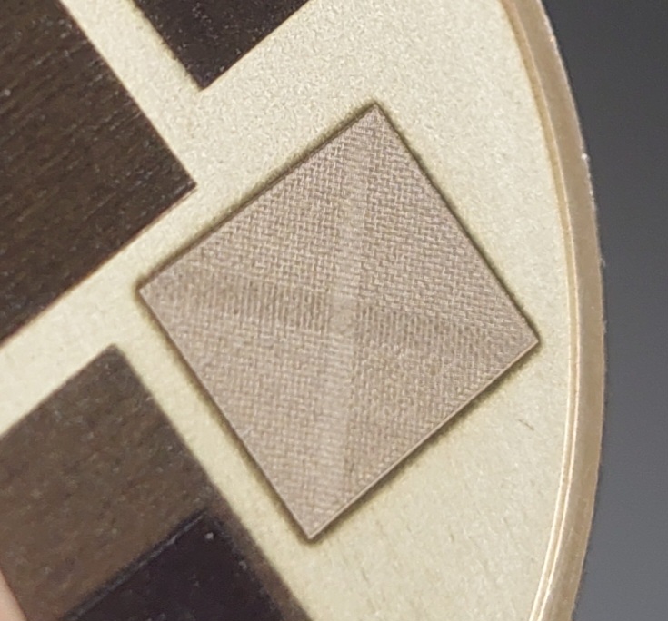

Burned outline and cross in testing square
Hello all first time here!

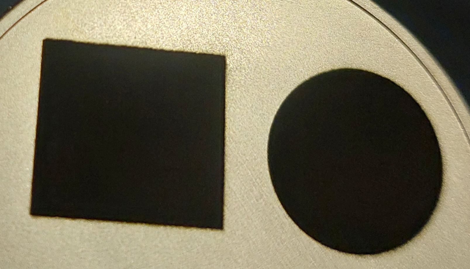

I have just encountered an issue with my marking. I have been using my 30W JPT-LP Litemarker Fiber Laser for a while now and for the first time a filled square i tested have a dark/burned edge with a cross in it.
Not sure if its related but this happened after i removed my lens for the first time which i worry that i may have done something with the mirrors. But i doubt this may be the case as i would imagine that messing with the mirrors would be very obvious by producing inconsistent messy results. I could be wrong.
Could i please be provided with any insight into why this may be and how to resolve it?

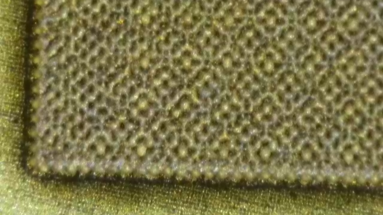

I have attached photos and i have never seen my markings look like this under the microscope either.
Parameters
Speed: 1500
Frequency: 25
Power: 50
Qpulse width: 200
Line interval: 0.02
Scan angle: 0
Passes: 1
Bidirectional + crosshatch
Thank you in advance for your time!

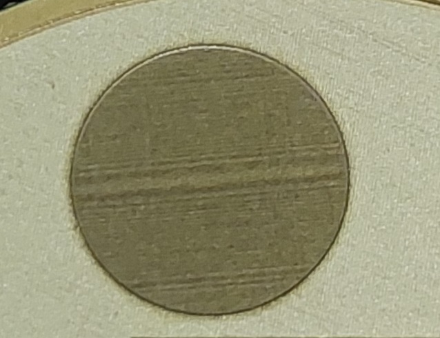

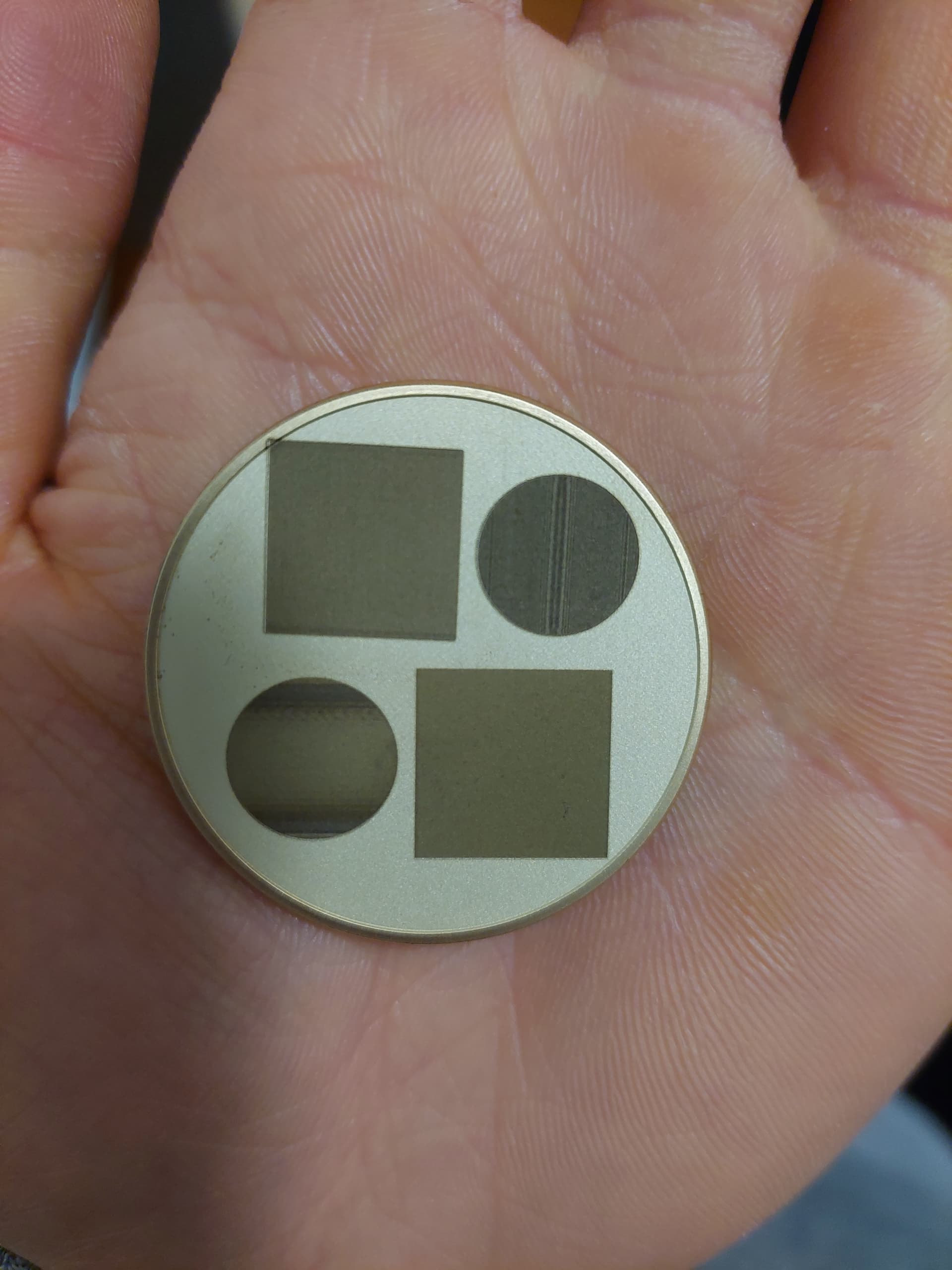

Just tested a circle and this is the result:

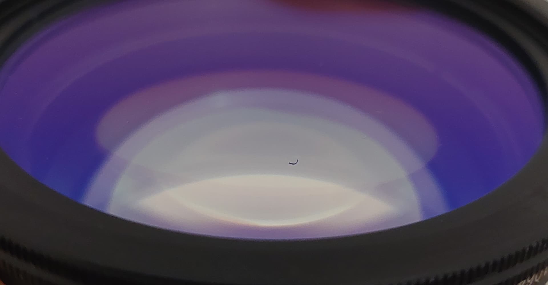

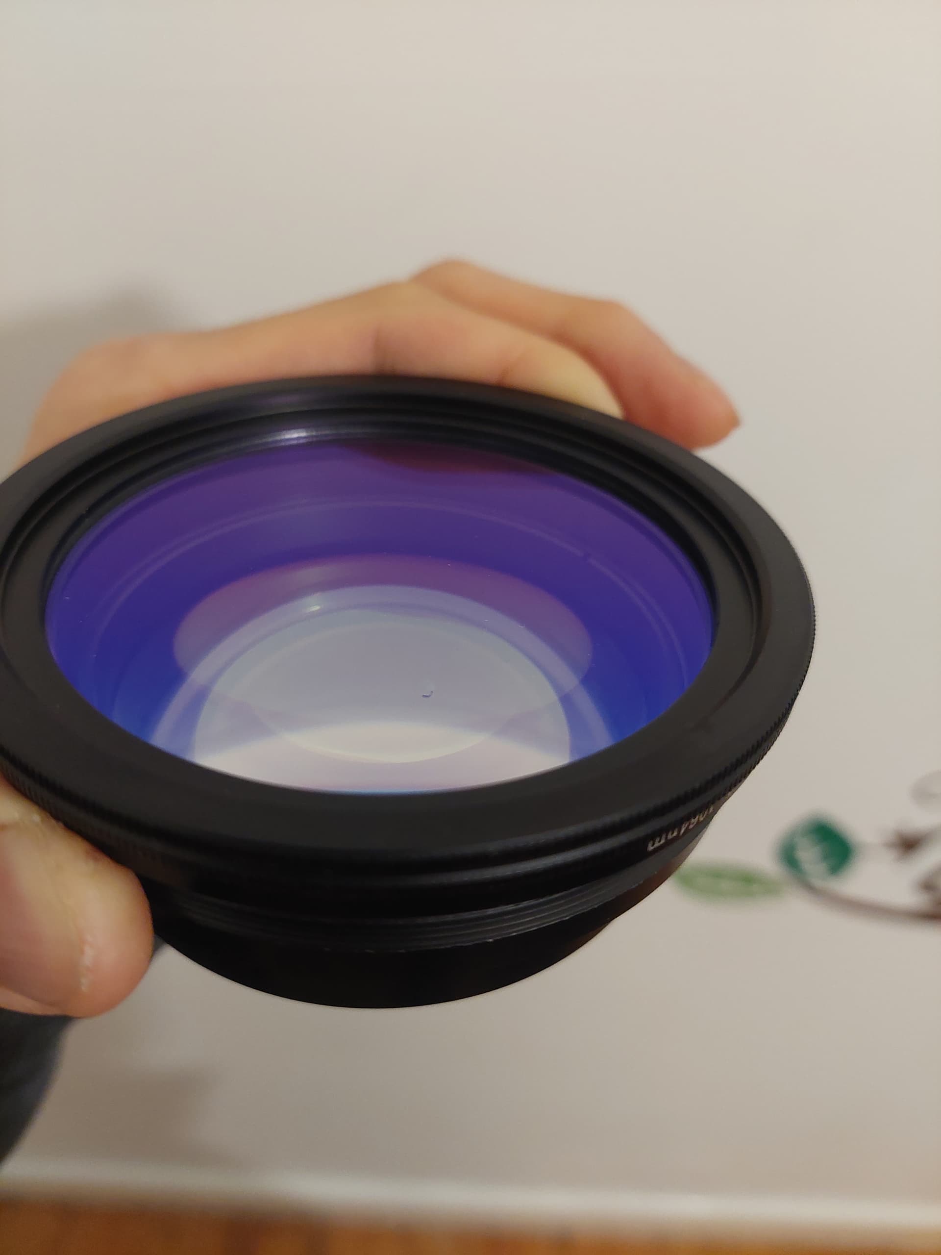

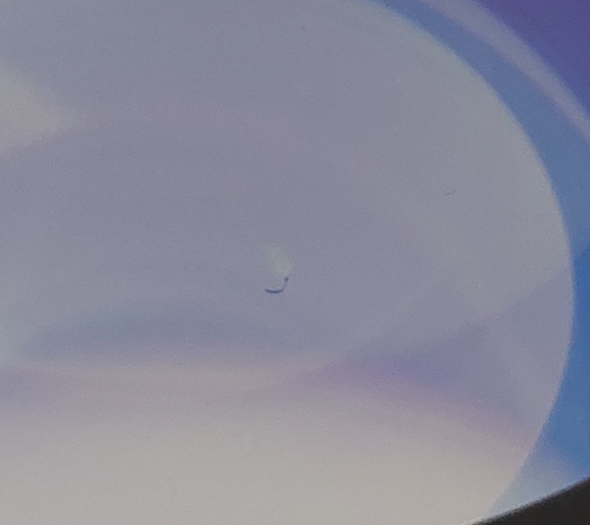

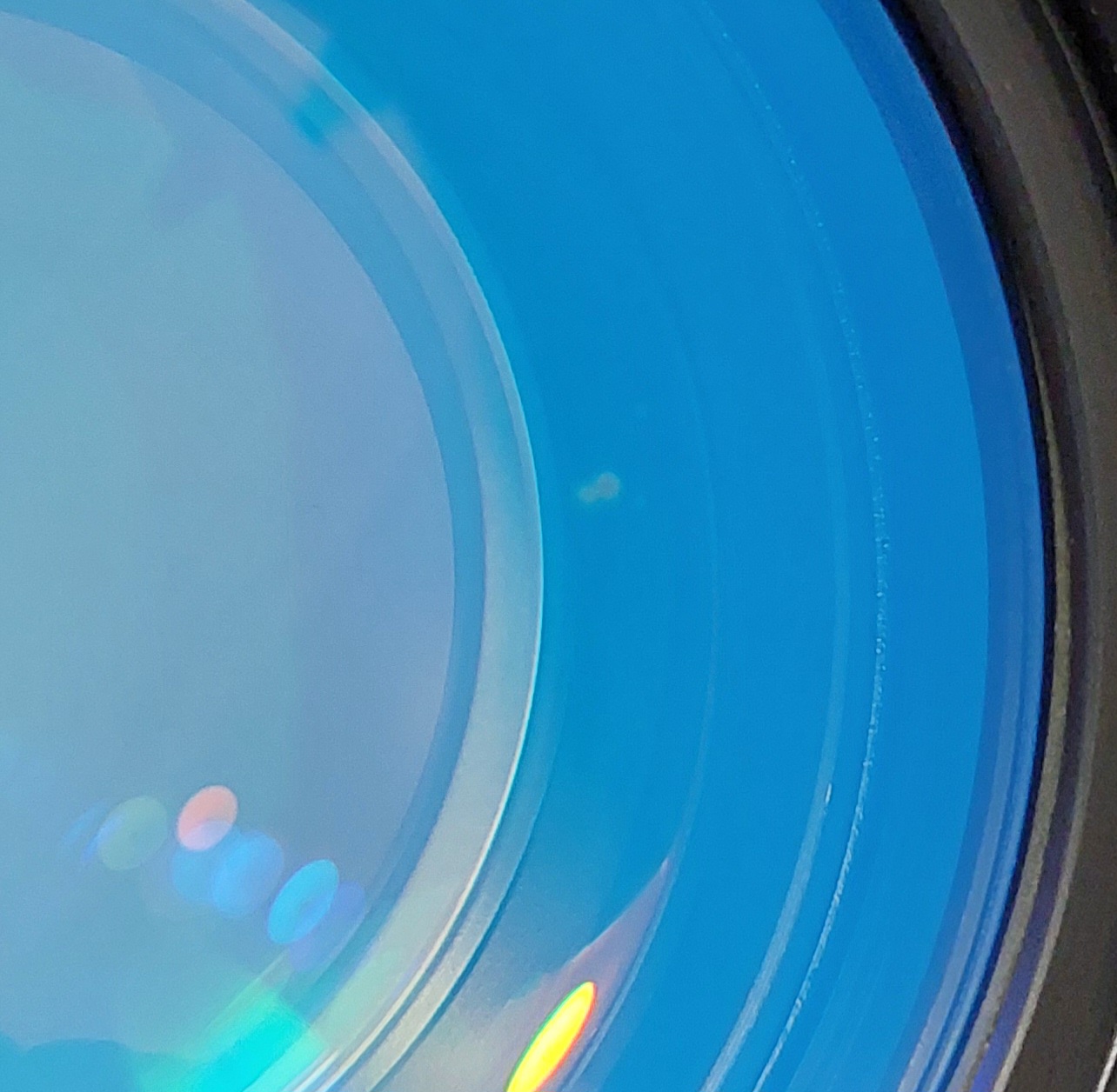

Another update: Removed my lens and found this. Didnt notice if it was there or not the first time i took it out to check. Could this be the cause or if this another issue entirely? Would have to get a replacement though but would like to know if its an issue with my laser or just the lens…
Doubt this is the issue, it’s not good, but I don’t think that small of area would cause this around the whole thing.
I’d turn off crosshatch and see what it does…
Good luck
Hey Jack, thank you for your reply! I figured it couldnt be the lens either.
I turned off cross hatch and these are the results. Still the same issues with the edges of my shape being burned deeper and the odd lines inside, particularly in the middle of the circle which never used to happen even with the same line intervals.
Do you think this could be an issue with the mirrors inside the galvo head? Or a software problem?

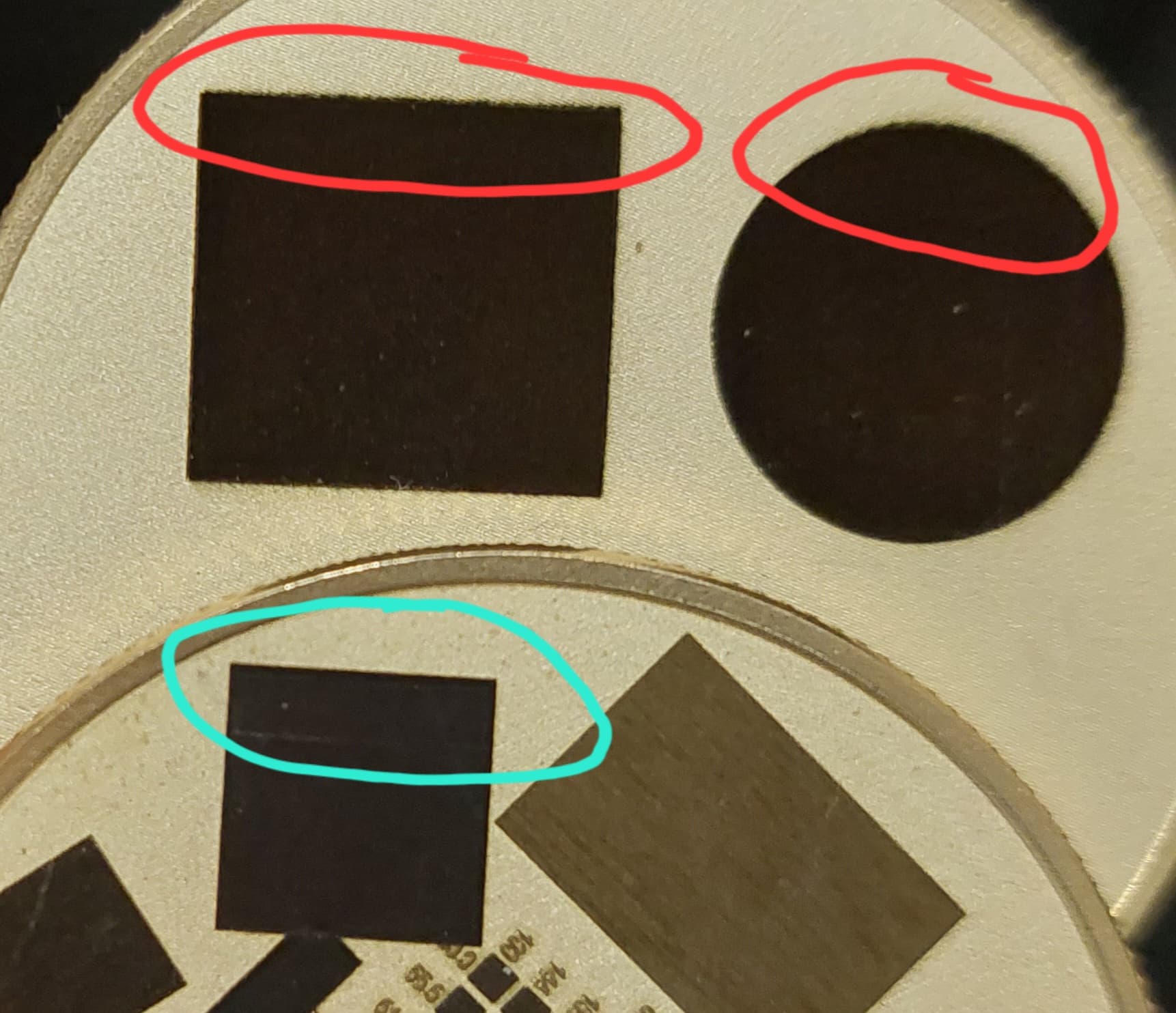

Just tested a setting i used for black on brass. The blue circle is a test square i did in the past where the circled edge is clean. The red circles are what i just tested with the same settings but comes with jagged edges.
This indicates that something has definately changed for the worse.
Not on Galvo, try your test on the reverse of the good one or from another supplier.
Sorry, can you clarify what you mean by “not on galvo”? I also retested on a new coin (same supplier as these are my only coin). Same results, jagged edges which never used to happen with the same settings, same coin.
I don’t have a fiber laser.
Test rhe same coin where you make your material test the one with the green circle (use the other side) . The surface seems more flat than the other coin.
ah ok, yep so same result. maybe ill try to re-correct my lens?
Update, i have swapped my lens from a 110 to 70mm. Issue still persists. Therefore i feel like it is not the lens thats the issue but perhaps the mirrors. Bottom circle with thick line, uses unidirectional while top circle with thinner line uses cross hatch and bidirectional.

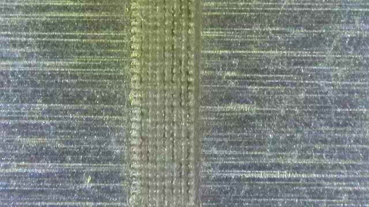

Also, as a general update for this thread, i just re-calibrated my jump delays and TC timings for the 2nd time hoping it would reveal another clue. Nothing again. Same issues still persists. weird line in the sames and it gets fuzzy when i do my brass black settings. also, deeper edge is also still happening. i played around with my TC ON/OFF settings with no notable differences. I have attached a photo of this under the microscope when adjusting my jump settings. Happens at the start of every text/shape.
