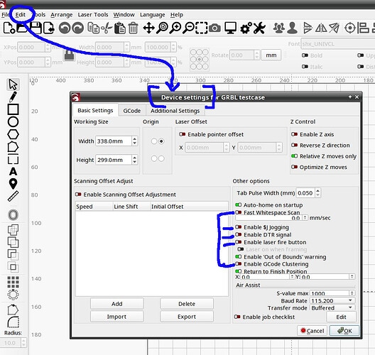

Trying to burn image and I keep getting error that says error code around line 9 or 10 and also something about a letter in the g code
Without more information, this discussion may be helpful (it’s for a diode laser, but the error seems about the same)l:
Your Genmitsu is probably a GRBL machine, so make sure that’s what LightBurn thinks it is.
If that doesn’t solve the problem, copy-n-paste the Console log to provide more detail on what’s going on.

This section of the doc explains some things you’ll see:
With more details:
Make sure you have plain old GRBL selected as the device type:
The other GRBL options apply to weirder GRBL ancestors and descendants than (I think) your machine has.
Then start with the simplest possible Device Settings:
With all that checked out, things should work better.
