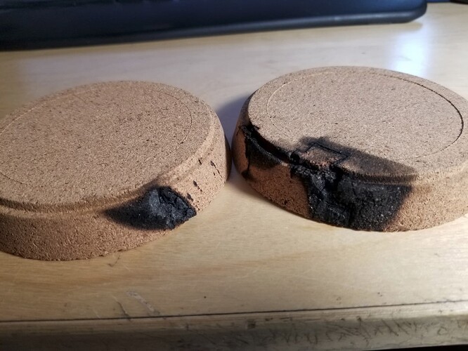

@Sasquatch is correct… You can fiddle with the settings and get a burn, but it’s the wrong tool for the job.
He’s also right that I am not the only one in the fiber boat. :crazy_face:
The only fire I’ve ever had from laser work, was the fiber striking a support that was made out of cork… out of focus but still resulted in an incendiary device.
I think the problem is what isn’t wood, such as the binding glue for manufacturing or the natural occurring tars and other chemicals that is in wood …
