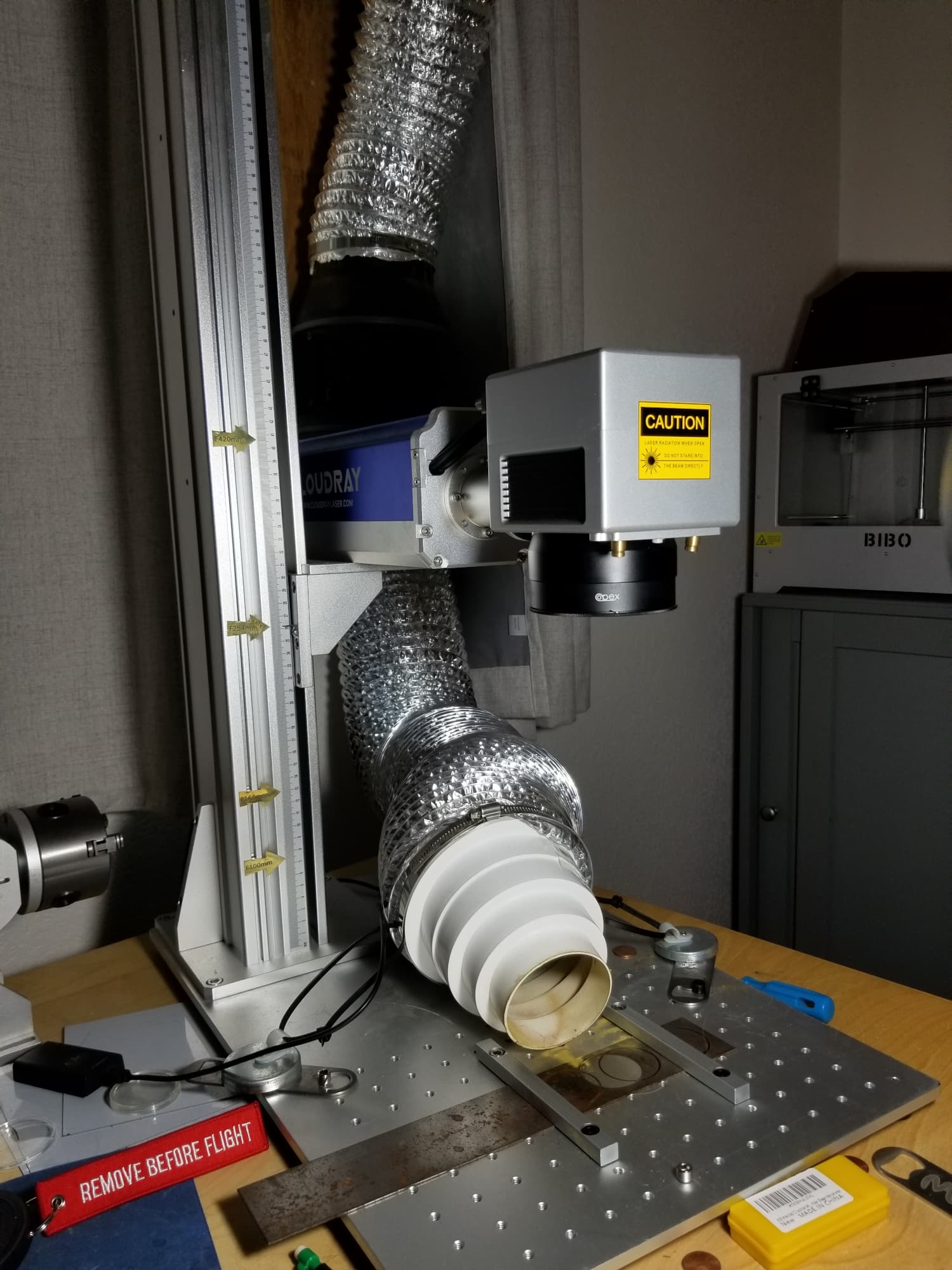

I got mine to learn on, much like the co2… Had it 10 months, so don’t know how much I really know about them…
Fiber machines are pulse type lasers, unlike a co2. I use pules/mm to help make adjustment decisions.
Maximum speed is really dependent on the galvo head. Mine is rated at a maximum of 4m/s. Had to ask Cloud Ray what glavo they used.
You gave three models, the first and last appear to be the same thing… at least I seem to get the same results via a search.
There are comparable models from Cloud Ray and other manufacturers.
Coverage is dependent on the lens, F type lenses are actually flat focus lens, so a longer lens will be a larger area. Keep in mind the the longer lens requires a longer (taller) column to be able to focus… The top arrow is for an F420mm lens, the bottom is an F100mm lens… These are relative to the table. If you want to put a rotary or anything of any depth, you need the extra column length.
If you want to have a 300mm square area, you’ll need something like an F420 lens. If you want this coverage, I’d order a machine with this coverage to ensure the supplied column is tall enough. Mine came with a 800mm column on the machine.
The lens has to be known, as the mm/s speed is relative to the distance from the lens to the material… Don’t know if Lightburn does this or if it’s the controllers problem.
In either A or B height the galvo moves the same, but the resultant surface speed is different.
