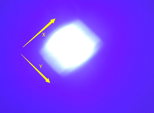

Hello
So that they know a little how to find out that a laser diode is damaged.
I contacted the sculpfun technical service, since I had my recorder under warranty and they asked me to do the following:
1 Connect the laser head to the 5V socket of the card.
2 Focus the laser on a wall, approximately 3 meters is recommended.
Depending on how the laser comes out focusing, it is known if the laser is bad or good.
I am attaching an image of how the laser should focus correctly at that distance. Outside of that opening range it gives symptoms that the laser is damaged.
light spot
I got a very wide, completely rectangular focus, without concentration on the light beam, nothing to do with the attached image.
A 10 for the sculpfun support team who sent me a new one.
I asked them how it is possible that it has been damaged if I have hardly worked with it in a year, just little things with the little time I have and they tell me that due to different environments and engraving materials, the laser may also be damaged and the machine will not be used for a long time, which will also cause the laser to become weak.
I hope this can help someone to rule out doubts if their laser is or begins to be damaged.
Text translated with a translator, sorry if I cause confusion.
If your beam looks different, it’s most likely a broken lens. You don’t need to replace the whole module. You can exchange the lens.
And for next time, make sure to clean the lens after each heavy use, this is essential to maintain the module very regularly.
