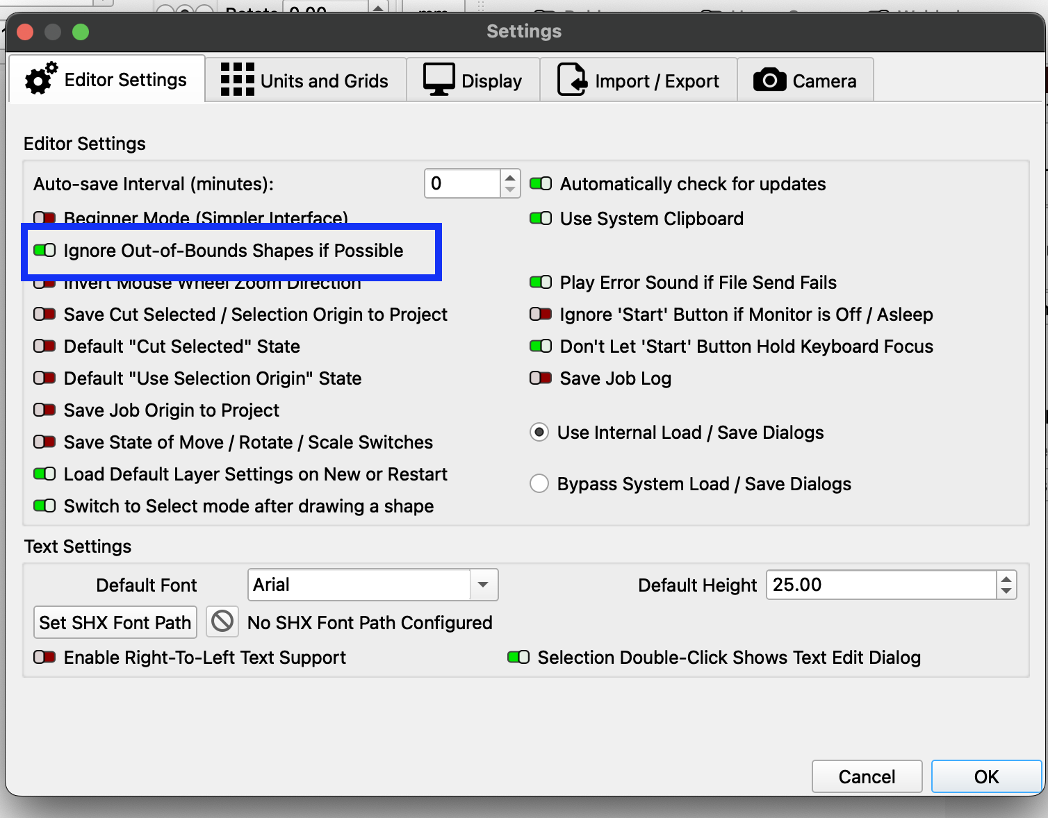

In the new version of LightBurn, I can’t calculate cutting time outside the cutting area. This is a problem when generating quotes, as I would have to place all the panels within the cutting area to calculate the cutting time.
Disable Ignore Out of Bounds Shapes, in settings menu.
oh ok… tks.
You can also change to “current position” and “cut selected graphics only”. Then you can cut everything outside the workspace by selecting it.
