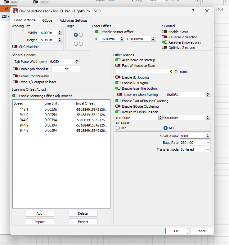

GRBL is potentially the correct device type but there are some oddities. For example, how did you arrive at 406x405mm for the work area? I’m also seeing some unusual output in the Console output in the previous post.
Did you use the .lbdev file provided by xTool to create your machine?
Can you take a screenshot of Edit->Device Settings->Basic Settings and also GCode tabs?
Ya. Prior to the 1.60.00 update, I was able to perform the calibrations.
The initial offset on your offset scan entries looks suspect.
I’d suggest recreating your device using the .lbdev file. That will likely resolve this issue.
