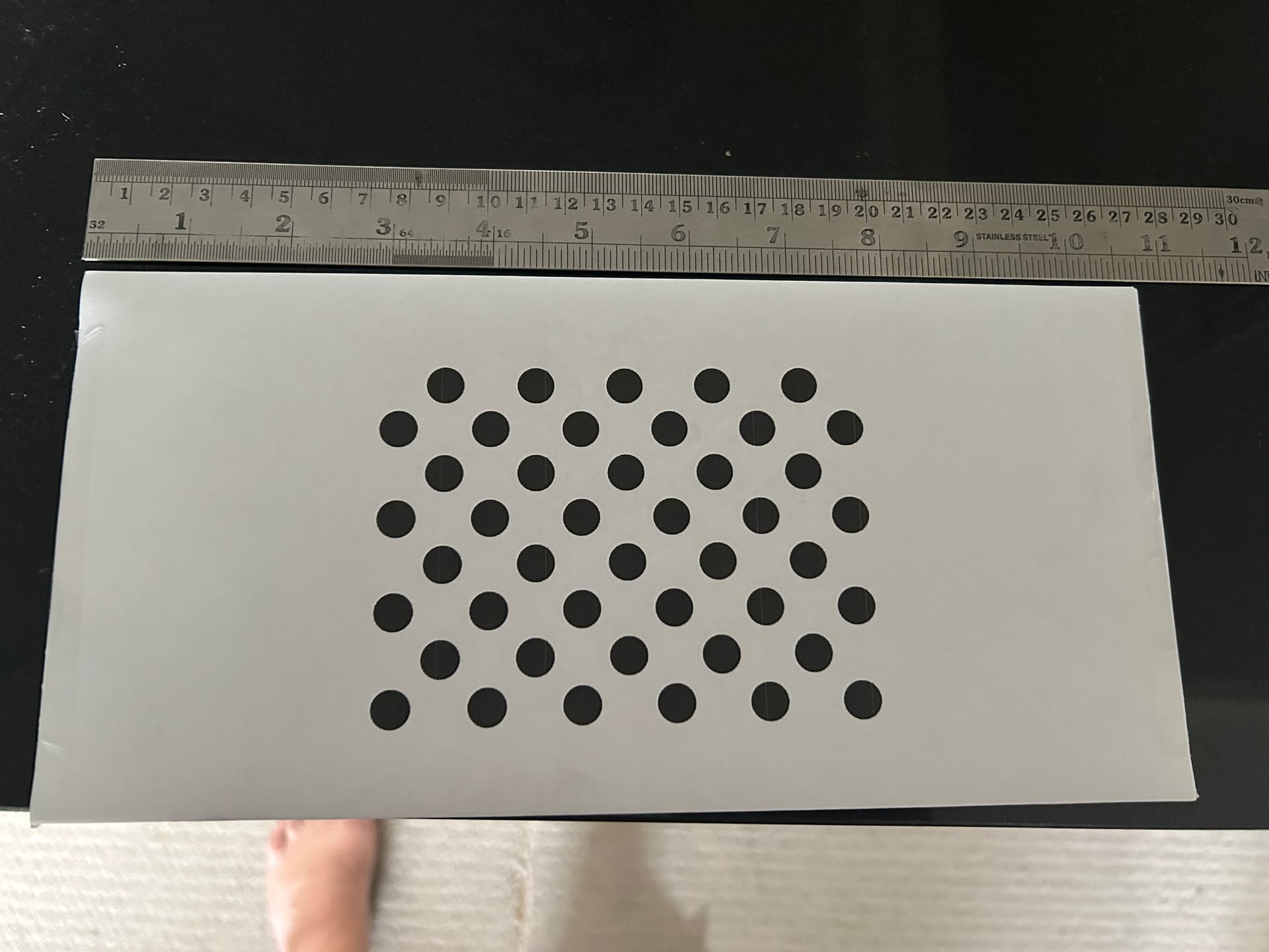

Running the Calibration for Camera Lens with circles printed out at original size on A4 paper on a cardboard. I have ran this multiple times and not all the time, the camera doesnt pick up the circles in the preview after the Capture. So results come out very warped.

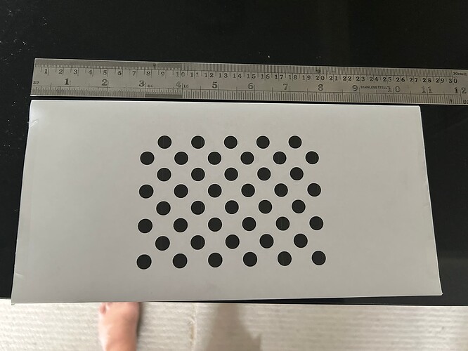

This is what i used for calibration.
You must get camera calibration and alignment completed for this to work properly. Typically you do this by completing the processes within LightBurn. You could also import a pre-done calibration if available.
Realistically you will need to overcome this for this to work. The single biggest piece of advice I can offer is to attempt to do this away from the laser bed. Mount the calibration pattern to a known flat surface like foam board or plywood. Then open the lid and hold the calibration pattern in front of the camera and repeatedly capture until you get good values at every position. Lighting is critical for this. I’d suggest a bright soft even lighting with no hotspots if possible.

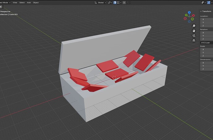

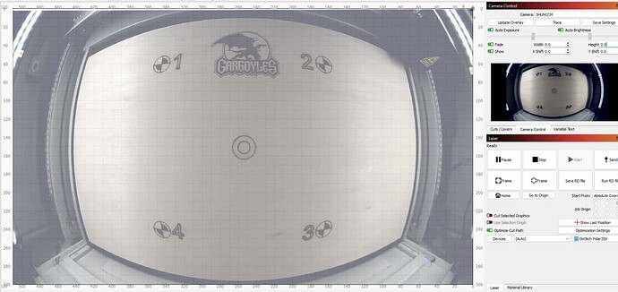

Worked this out and got it working! Now my Capture Image shows the workspace properly.
A lot of Youtube videos teach you how to calibrate from within the workspace with the lid (with camera closed), this didnt work for me. Then there were also videos that did it with the lid open, but you face the circles at the camera on the lid.
I managed to calibrate mine by doing the following placements.
