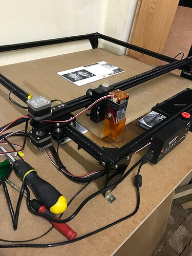

Hi,
Changed the sprockets and steppers on my Genmitsu laser and something has changed after the upgrades it moves slowly and it isn’t going where I want it to move. I changed the steppers from 1.8 angle to 0.9 angle also the sprockets too. Now lightburn thinks my work area is around 220mm x 230mm instead of 600 x 600 tried to calibrate the steps in lightburn by drawing a 50 x50 square and got a 20 x 23 square.
Any help you be appreciated.
It should go up to where the tiles are.
Any help would be appreciated.
In which way you do that calibration?
While you can use the axis calibration in lightburn, that’s really more meant for instances when tolerances are stacking up such that your steps/mm are slightly off from what’s expected.
For you though - you know what type of motors you are using, you should know how many teeth your pulleys/sprockets have, and it’s likely you are using 2mm pitch belts, but that’s easy enough to measure.
I recommend taking a look at this which includes details on how to properly calculate your steps/mm value:
https://lightburnsoftware.github.io/NewDocs/Troubleshooter/StepsPerMM.html
