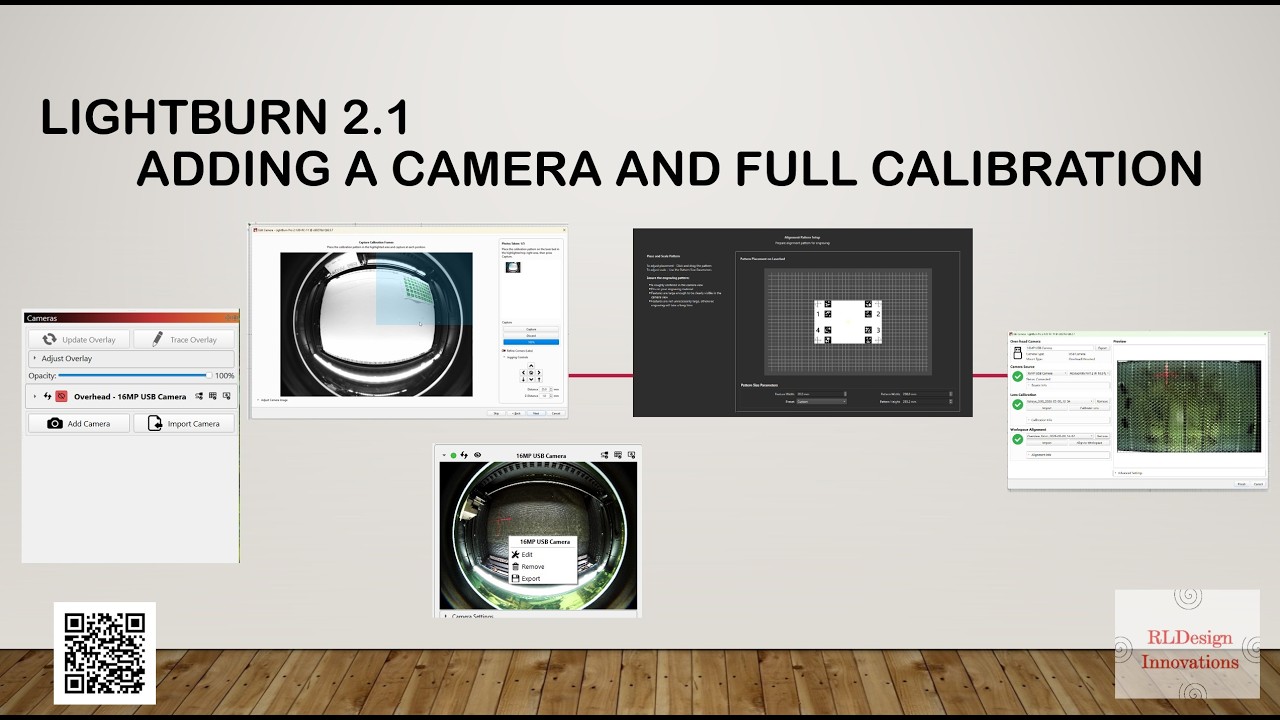

This may help you with camera setup, I did this video a while ago.
Interesting! I got better results the second time by just leaving the April Tags in the center.
The first time, I took lots of captures just like in the video. Maybe it is necessary for a fisheye lens and not a regular lens?
Mike, it must be luck and/or your machine bed is not very big. All lenses have optical distortions, fisheyes are the worst. Typically the center of the lenses will be the point that is less distorted than the outer edges - therefore there is more to calculate and correct in these areas of the program. But - if it works well for you, that’s great and shows again that theory and practice don’t always match :wink:
Theory is for the engineers. Practice is for the technicians. Engineers make them, technicians make them work. :joy:

Things I noticed in the video posted above:
  • You can leave the laser lid open while performing the lens calibration.
  • You absolutely should glue the AprilTags card to a flat board. The process measures the distortion of the lens. If the calibration card itself is distorted, that won’t work well.
  • Preferrably, you capture multiple images ranging all the way to the edge of the camera’s view.
for what it’s worth 1Laser had me calibrate with lid open and holding the april tags about 36" away in various positions. 9 takes made it happy. Alignment was a whole different animal.
