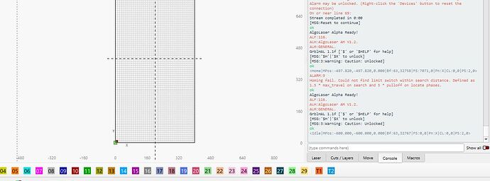

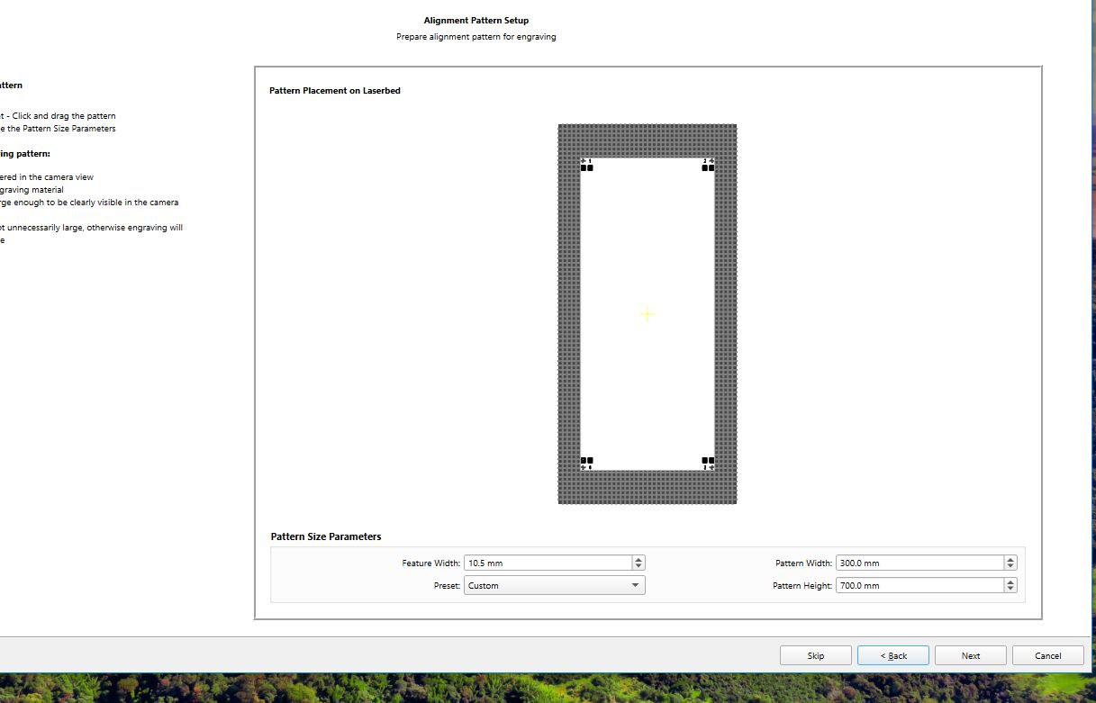

Camera aligment error

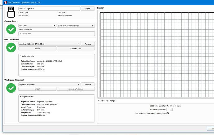

setting up camera , done tags no errors

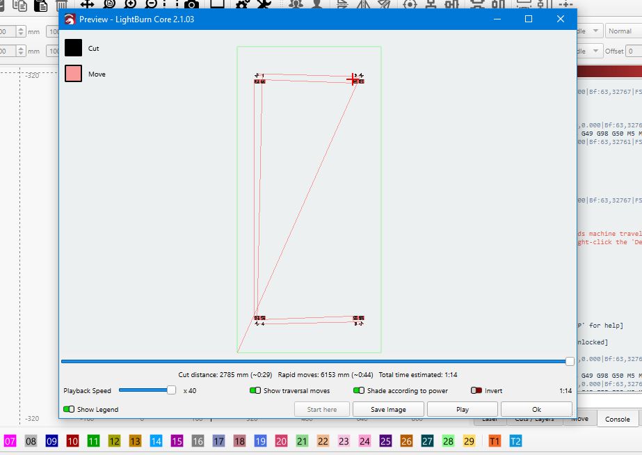

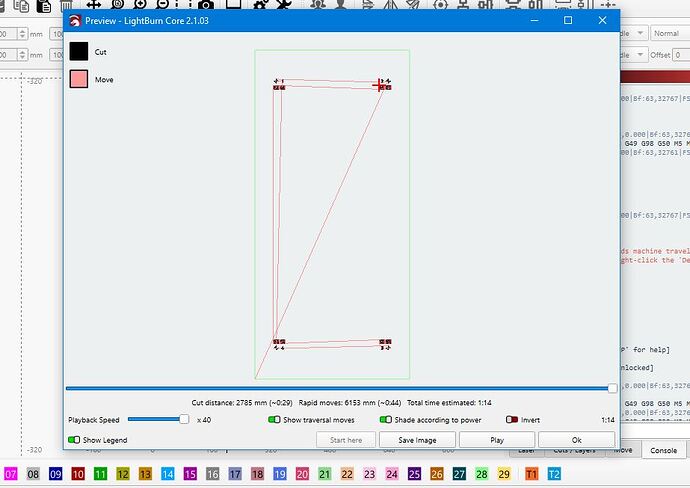

on alignment machined is homed trying to do this all looks good in preview

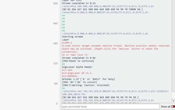

when i click start it goes to far end and than i get this error
go out of aligment and click home than get this error

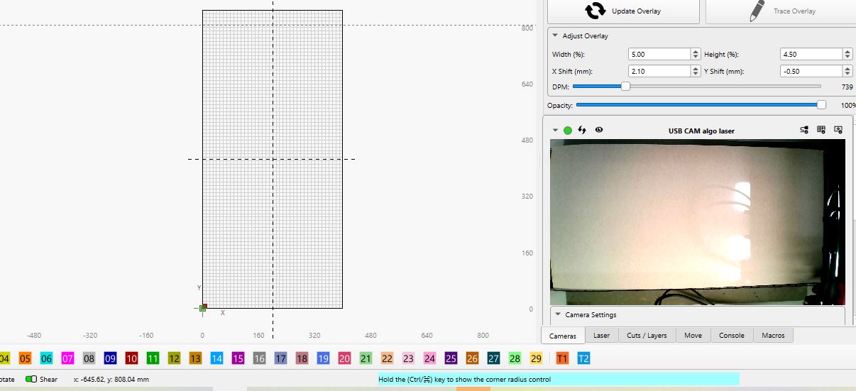

click update overlay nothing happens

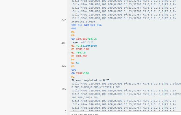

i can run a full permiater operation with no errors Y 847 X 389

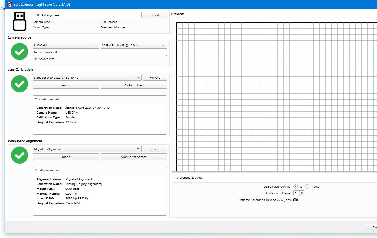

I’m a little confused that you have in your profile “Your laser: xtool d1 pro 20 w” but in the pictures shown there is a different bed size.
In one of the error messages it says that it “cannot find home”, it could be related to the mismatch in your used X Y dimensions/home position.
Something else that catches my eye is that you are using very small April targets, is there an explanation for that? And why is your DPM set to 739? There are also different results in your camera lens correction and workspace alignment, which I don’t remember being “normal”.
My suggestion is to start by setting up your machine with the physical dimensions it has and use an “auto” process for calibration. You can always change/fine-tune it later if the basic system itself works first.

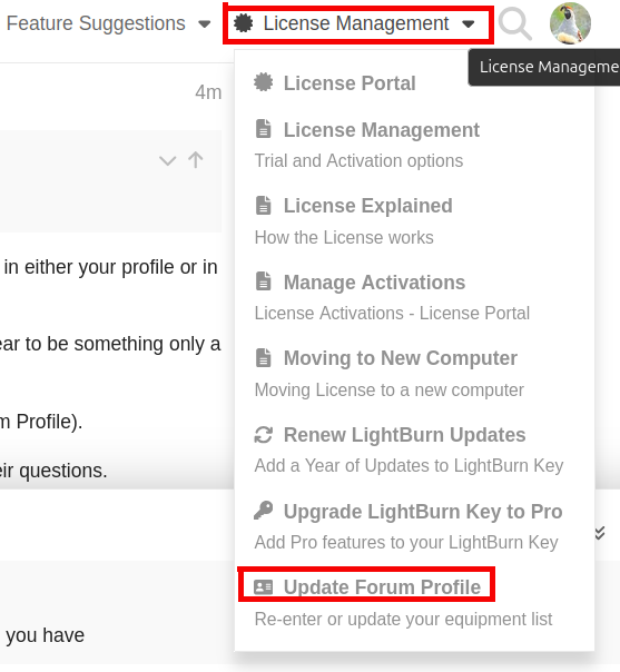

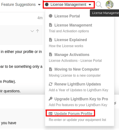

havent update profile since i threw that piece of junk in the bin, cant find where to change it under profile

that is the defult size that comes up , DPM again that is what comes up i havent touched that
camera has worked fine in previous version, just not this one , so un installed and did fresh install to see if it wouldwork but it still dosent

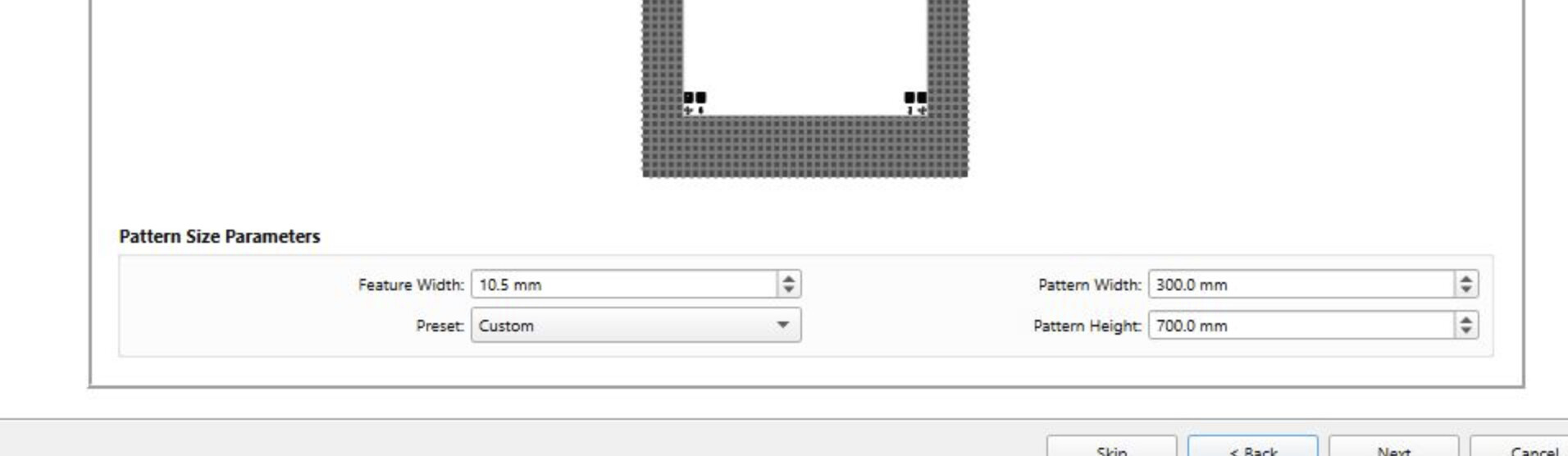

Picture says something else… mine for example, is set to 30mm and DPM should (here for me) be set to max.
Inexplicably, that’s under License Management:
how does pic say something else, thats great yours is set to 30 , as i said before that is what comes up on my screen same with dpm , did you ever think that did camera will have dif settings and DPM
cheers the one place i didnt look

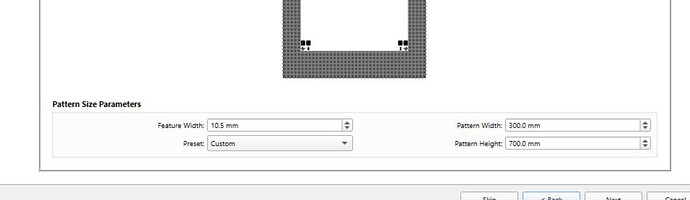

Preset: Custom
it changes to custom once you change the pattern width and height
mikey you got any ideas as to what would be causing the exceed machine travel,

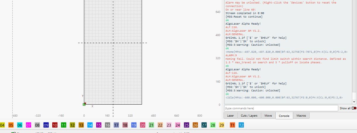

seems odd that when running jobs, it homes correctly ,runs full bed of 400 x 850 , no errors
but in camera alignment it sends alarm codes of exceed travel
i assume in new versions of LB like in MM if bed size in device settings is dif to board size in machine settings a warning pop up would appear, i haven’t had a pop up
hmmm the more i think of it the more it makes me wonder during update if it defaulted machine settings to 400x 400, but not device settings and no warning has been activated

no im trying to set up my camera under camera manage so i am able to use it , but its the final alignment process that wont work
always with you :slight_smile: re absolute tripple confirmed
thats the problem the camera wizard is causing the alarms so i cant complete the alignment process, so cant even get to the overlay capture to work part

i had camera working in older version but camera overlay wouldn’t work in this version , so deleted camera and am trying to reinstall it , but now have hit this error
From what I read, this is a completely different camera setup.
Let me know if you are ready to go step-by-step.
First, read thru my posting…
same camera , just did full reinstall
i found the problem when i updated LB it
thats what it had done, in machine settings it had change y from 850 to 400 ?
once i changed Y back to 850 , it ran alignment setup sweet as camera now working and update overlay works
