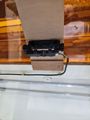

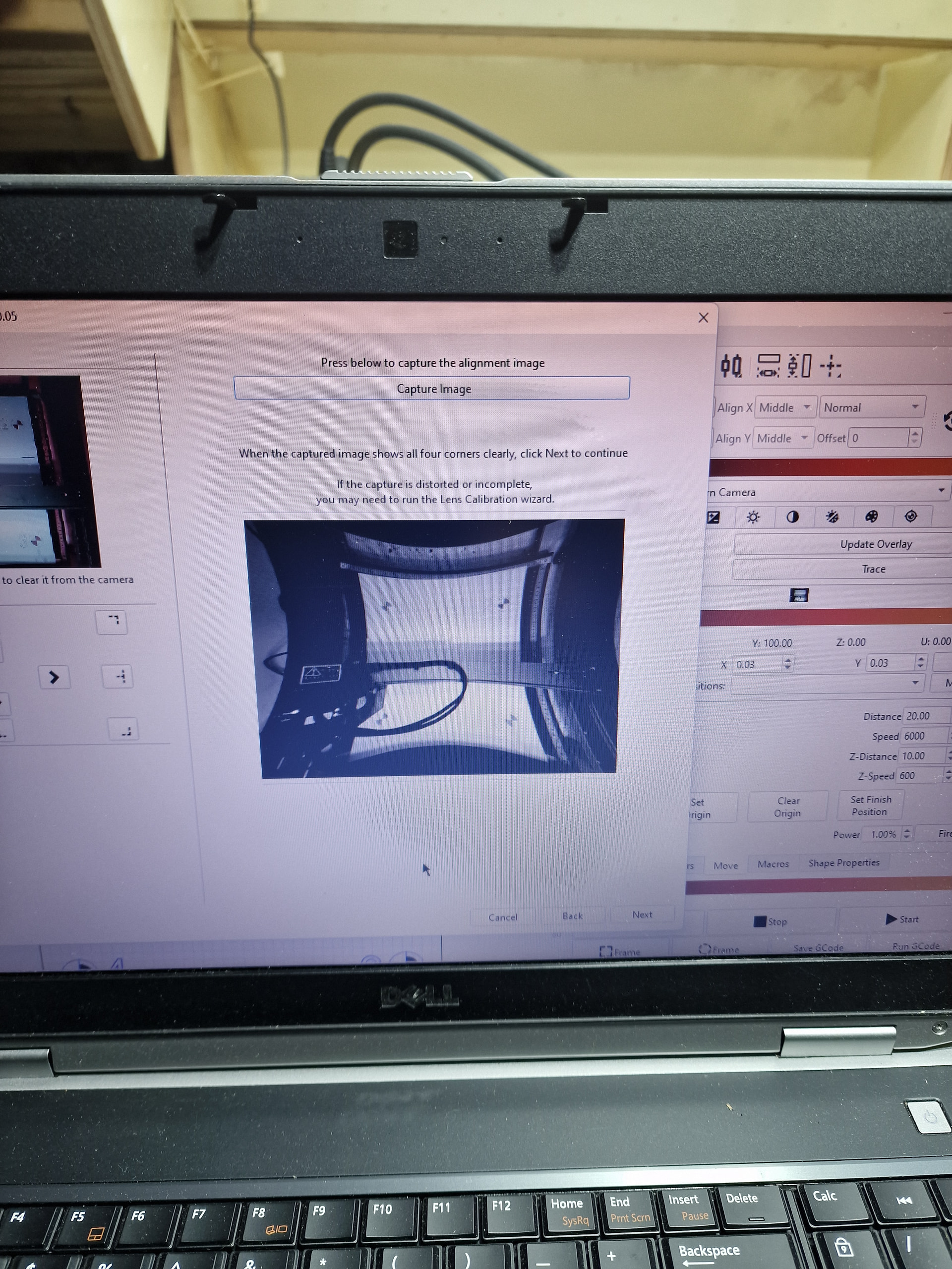

Hi. Sorry for another camera question. Ive bought a used Creality Falcon2 with a Lightburn camera all installed in a hard enclosure. Ive just got a second trial of lightburn as my 1st ran out while waiting for my new engraver to arrive. The issue is that when trying to calibrate it, the final capture is distorted. Ive done it from an 8 inch size now gone to the whole bed size of 400x415 mm and its got hellishly distorted now and Im not too sure where to go. Ive done it multiple times wirh various different parameters but its always the same. Oddly enough, with my old setup which was a cheap camera from Amazon it was perfect 1st time. Im stumped somewhat. Can anyone please help. I really like Lightburn and will purchase it but would ideally like it all working on this set up first.

Thanks for replying. The camera is mounted directly above and horizontal to the work plane, pretty much in the middle. It is a lightburn camera 20 inches above.
Calibration goes well, as does the alignment, Ive done it a few more times, however, the overlay picture is very distorted still. Incidentally, the preview picture is miniscule, around 5mmx5mm. I expect that is significant but not sure how.

Your camera mount looks very nice and stable, there is nothing to complain about.

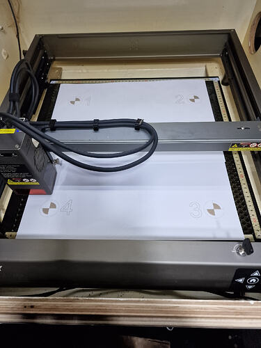

A very important detail is to adhere to the order of markings, 1,2,3 and 4. Then you must relate to the updated preview window and not the one in the small results window.
If nothing helps to get a proper result, you must start over again. It is not optimal but that is how it is at the moment.
