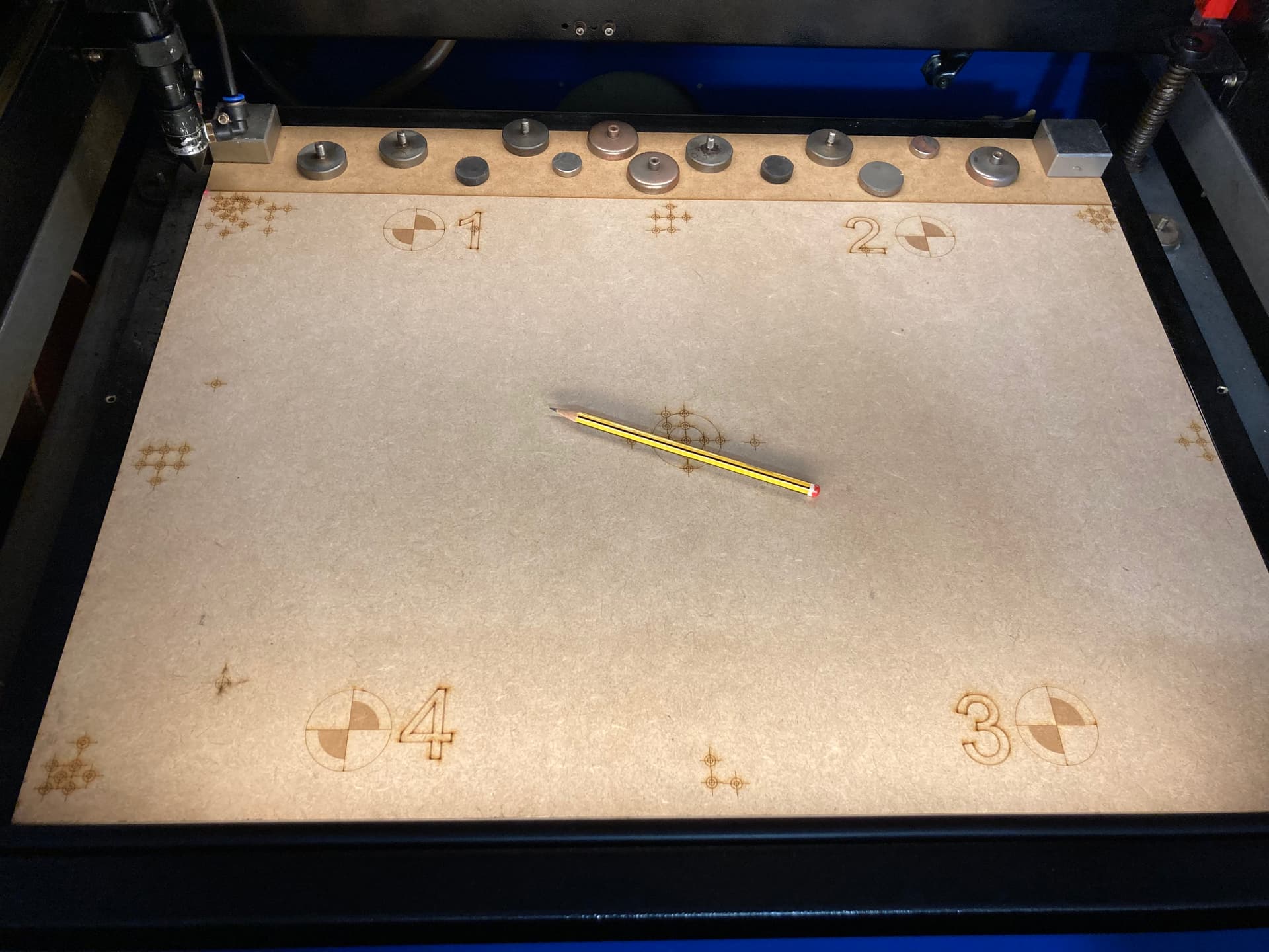

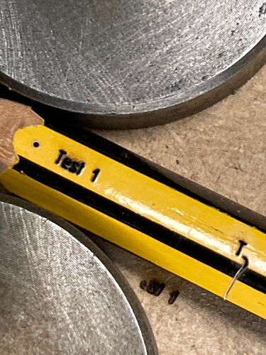

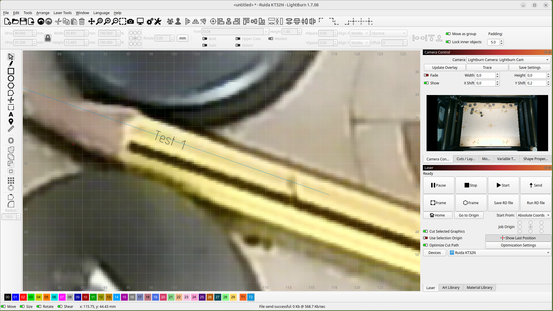

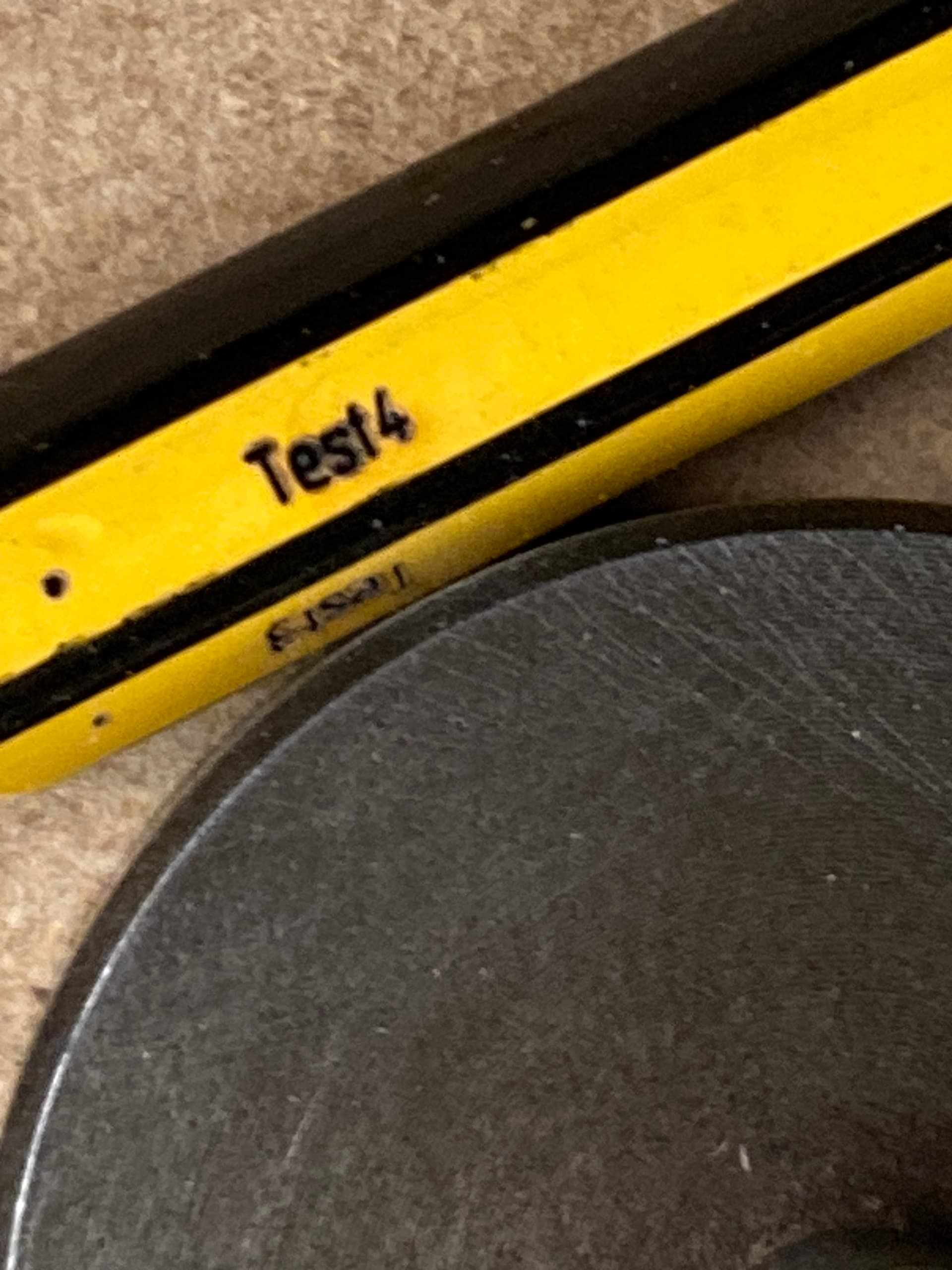

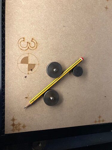

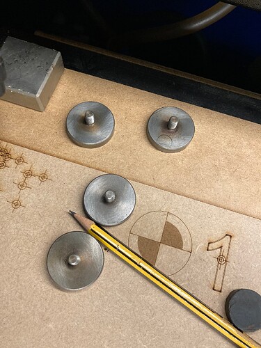

I couldn’t resist… :wink: part1
Part 2
Part3
In “Part1”, notice the little dots, these are my align/test dots, if they are ok I pull the text.
If I “forget” to correct for the pencil height (focus) I am typically 2mm off
