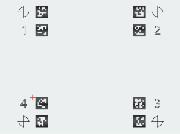

We hear you. In fact, future LightBurn versions will do exactly that!
Here’s a screenshot of the calibration pattern of the PreRelease version 2.1:
The QR-code-looking tags are AprilTags, which can be detected automatically by the camera.
The UI and usability need some more testing, but we can look forward to auto alignment :slight_smile:
