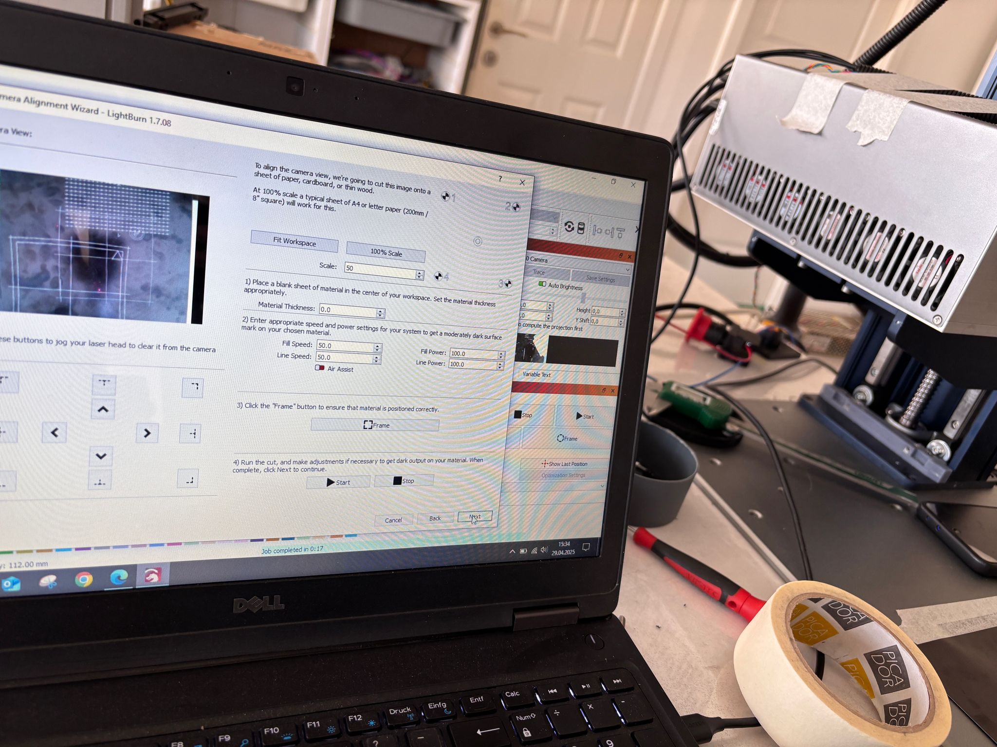

Hi there, im trying to align camera with my 5w uv galvo marking machine. There is laser type selection on camera alignment wizard settings. so when try to mark, it is can’t do it.
There is no problem on marking when we using on main screen.
What should i do?

Hello Osman,
I’m not sure what you mean. Your picture shows the Camera Alignment Wizard. You need to first choose your laser and then open this Wizard. Enter the desired Speed and Power for Fill and Line and click on “Start” to engrave the target markers and select them in the next step.
Is framing not working for you? - I never had the need to use a camera on a galvo. The red dot framing will always be more accurate than the camera overlay since it shows the exact position through the same lens.
