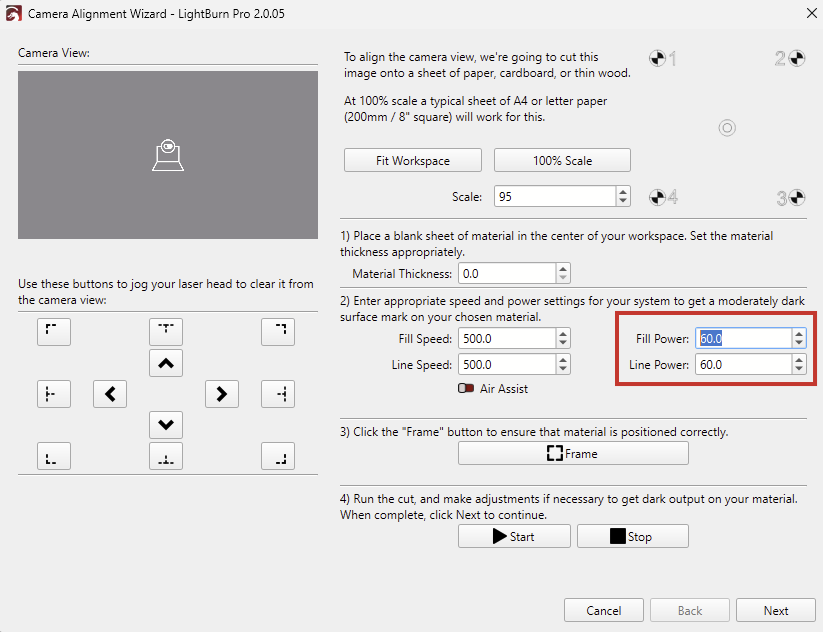

Camera Alligment Problem Lightburn 2.0.04
UV laser sources are special, in that they always fire at 100%, but adjust the power with the Q-Pulse (Pulselenght) in Nanoseconds.
The Camera Alignment Wizard in version 2.0.05 is missing the necessary settings to adjust the power on a UV laser.

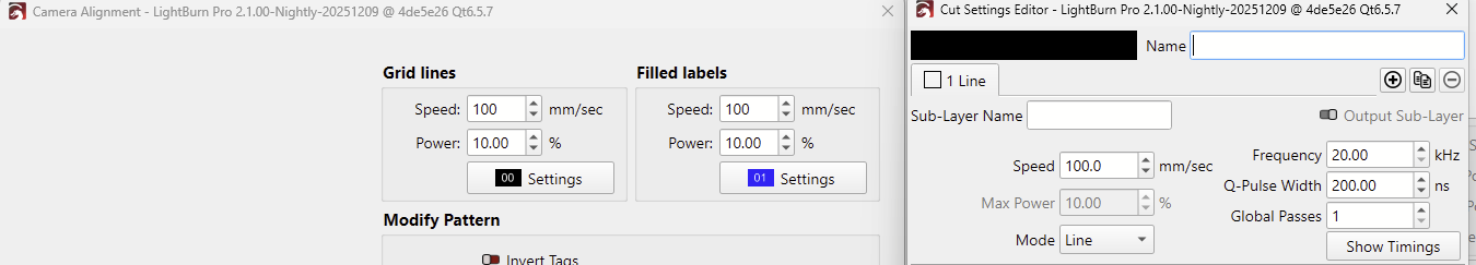

In the upcoming 2.1, it will be possible to access the entire Cut Settings. Here’s a preview of what that will look like:
Your workaround to manually print the target markers will work, if you consider a couple of things.
I’ve explained them in this thread:
