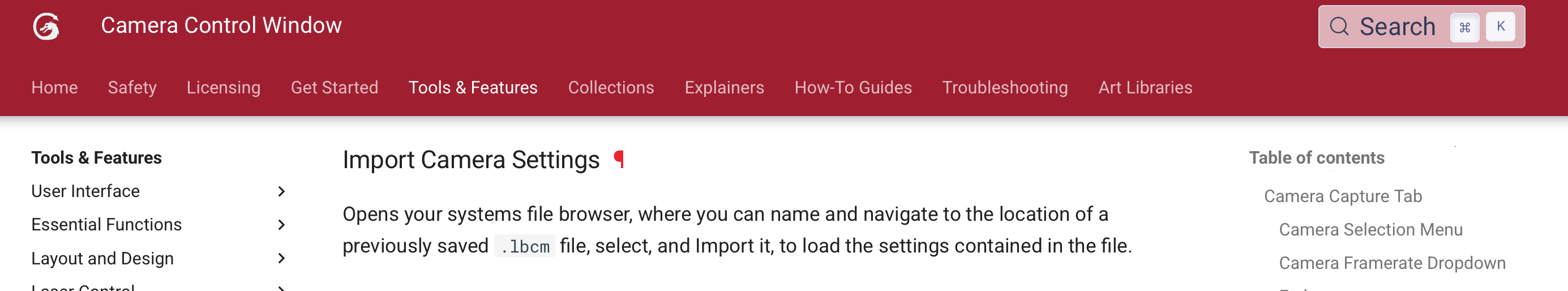

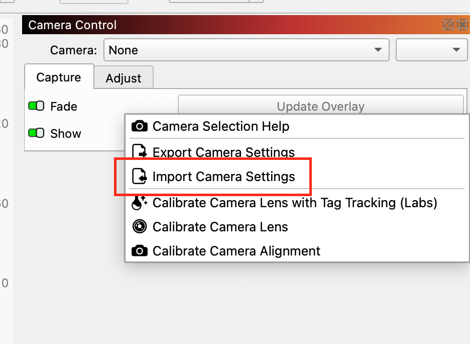

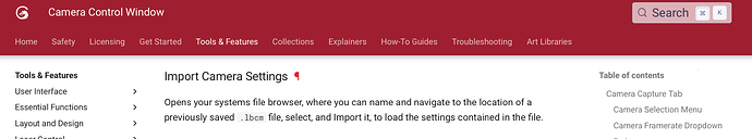

Try importing the settings after you find them on your system.
