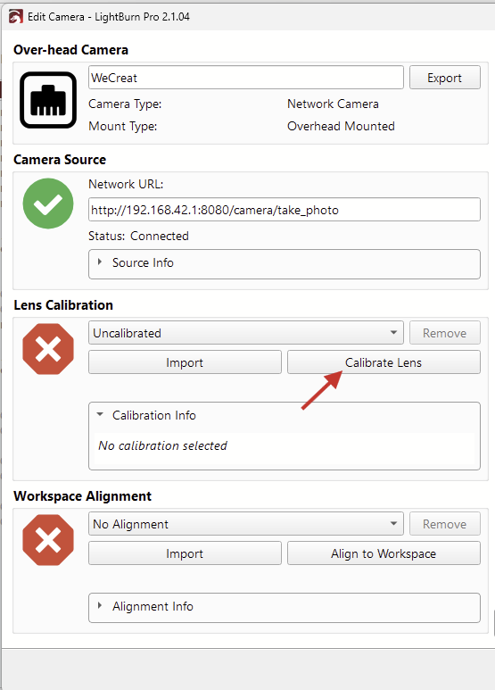

Now I’m try to calibrate my camera using the Lightburn documented instructions.
When I go to the Camera window I see the Wecreat camera displaying the laser bed, so I assume its recognized the Wecreat camera.
I right click on this window and get header “WeCreat” with options to Edit, Remove, Export"..
When I click on any of these 3 options I do not see any option to identify this camera as
being “pre-calibrated”. Where do I find this?

The New Camera Wizard should have offered to select a “Precalibrated Camera”, but I see that’s not an option when loading the WeCreat camera from the included presets.
I’ll report this internally.

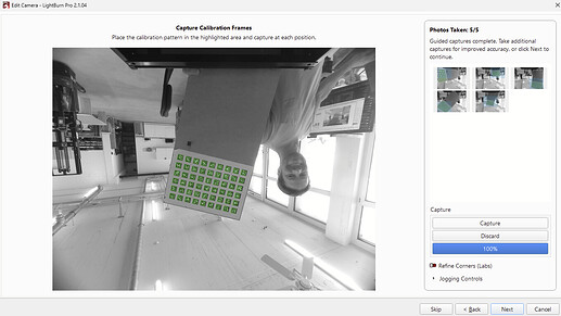

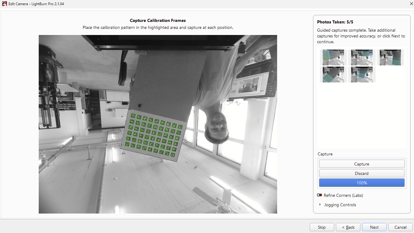

Even though the manufacturer states that their camera is “Precalibrated”, I found that the results are better if you calibrate the lens using the AprilTags card, as explained here:

I did make some headway getting as far a printing the calibration pattern but could find how to verify the pattern.

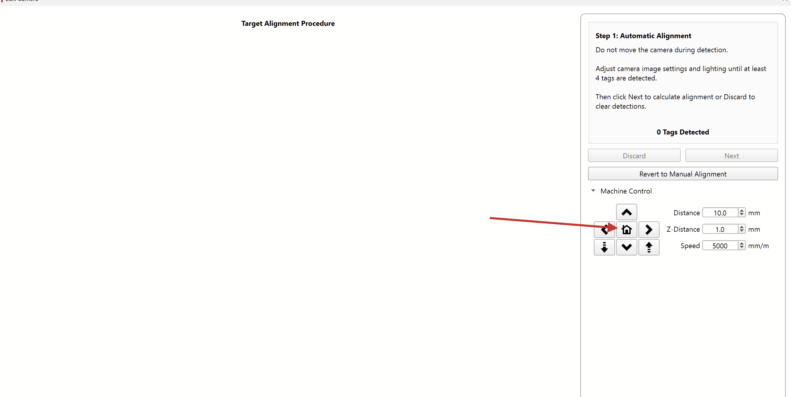

One of our devs already wrote the changes to automatically select the “Pre Calibrated” preset in this step.
Currently, you need to perform a manual Camera Calibration by clicking “Calibrate Lens”.
It’s quick, fun and only needs to be done once.
You can do it with the lid open.

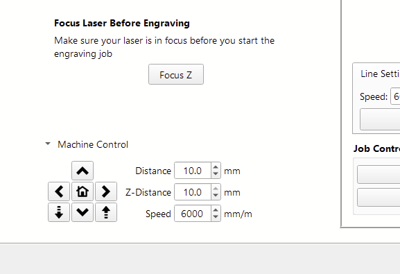

The “WeCreat specific Instructions” are not needed anymore, now that we have the “Focus Z” button in the Alignment Wizard of version 2.1.04
