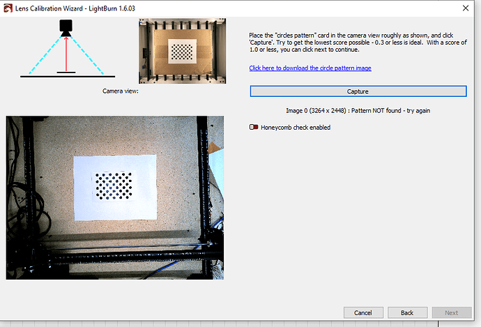

I am having a beast of a time calibrating my camera in lightburn, purchased it with my longer ray5 (came as a set). i got it to work once, then when I purchased and installed my license code - LB would not see my camera settings any more and when i go to configure them, lb can’t see the pattern. also when i went to comment on an existing post i was unable to. Please help

Show a screenshot. Make sure there is sufficient lighting and no reflections. Some tips are here: Using a camera with a diode laser - Diode Laser Wiki

There are a few things that you can try. The circles are far too small. Print them on a full A4/letter sheet of paper. On normal paper, it’s also less shiny. Next, mount the camera lower. You don’t need to see the frame of the laser. Mount it such that it covers the full work area, not more. Then you also will get bigger objects and the usable resolution increases.
Turn the image for 180 degree.

working on this again today - still no positive results. what is making me feel as if there is an issue is the speed in which the calibration failure comes back. almost instnatyl. if i turn off the Honeycomb enabled check box, the system will pause as if it is really looking or trying.

tried both the calibration card that came with the camera kit, tried with a print out from the download (within lightburn) both are on white paper, tried to rotate the pattern 90° -

I find the tags work better, and are picked up quicker with the newest version

Please try using the new April tags instead of the dot pattern when calibrating your lens and using the latest version: 1.7.03
