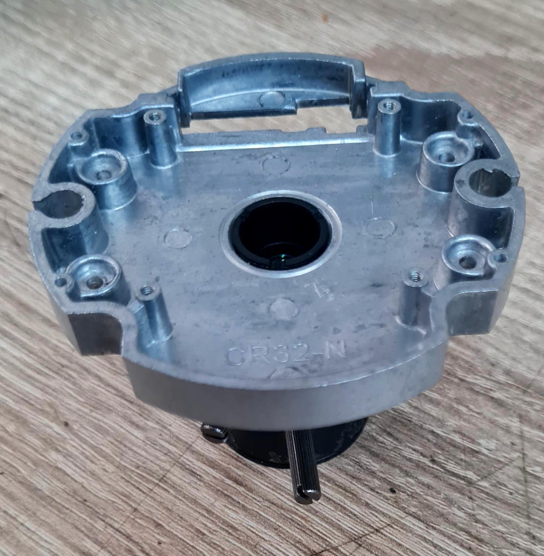

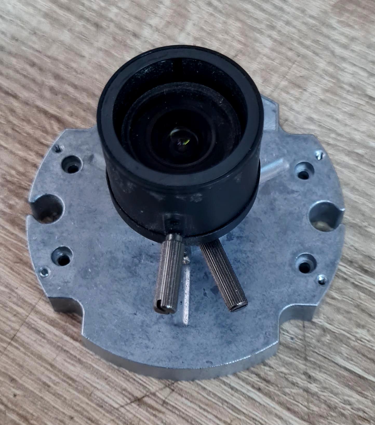

8mp fov 120° with autofocus works wonderfully with lightburn, all for 8€!
If you are able to get one of the old (defective) CCTV cameras (preferably with xMP lenses),

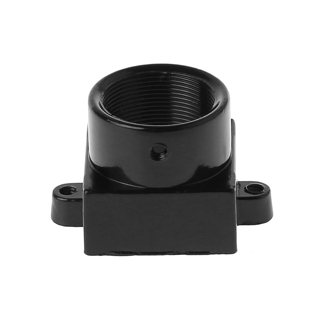

with a cheap USB cam module from China, you will solve the problem very well and cheaply!
95% of cam modules have a standard range of holes for connecting the lens and attaching it to the bracket! Everything else is your imagination and skill!
