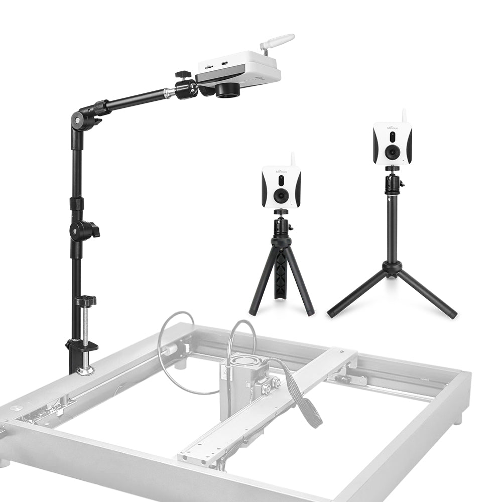

I bought a second hand Mintion Lasercamera! It’s very good: I can also use the wifi and drive from my room the laser in the garage next to it.
…and then the old discussion comes up again ![]()
LightBurn, the fire department, insurance companies and many of us scaredy-cats, who may have even tried to set fire to their machines, are not in favor of this way of working with a laser machine.
But, we (most of us), live in a free world.
Nope. My computer is only a door apart from my laser: hence I protect my vision and my lungths. Feel free to sue Mintion.
