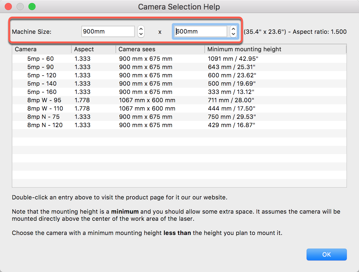

We are not going to be able to provide a solid answer because there is a major data point missing. You need to measure the distance from your chosen mounting location to the bed when the laser is in focus.
When you have that number, go the ‘Help’→’Camera Selection Help’ in LightBurn to expose this window. Enter the size of your bed to see the best options that match your needs. If you double-click one of the choices, you are taken to that page where you can purchase. All explained at the bottom of that screen as well.
