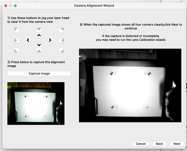

Camera image is blurred
The set up is for a Omtech 50w JPT with built-in camera on a MacOS
I can’t seem to get the image to focus and the Wizard tools do not change the image clarity. Is there a set up somewhere else I need to do?
In order to align the image to the bed in software, it’s essential that the camera has to be focused manually before the final alignment.

Because I am using MacOS the software that came with the machine for the camera cannot be loaded in my system.

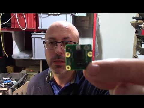

Take a look at this video that shows this for a Raspberry Pi camera:
Again, I can’t quite tell from the photo of that’s a focus ring but it does look like one.
