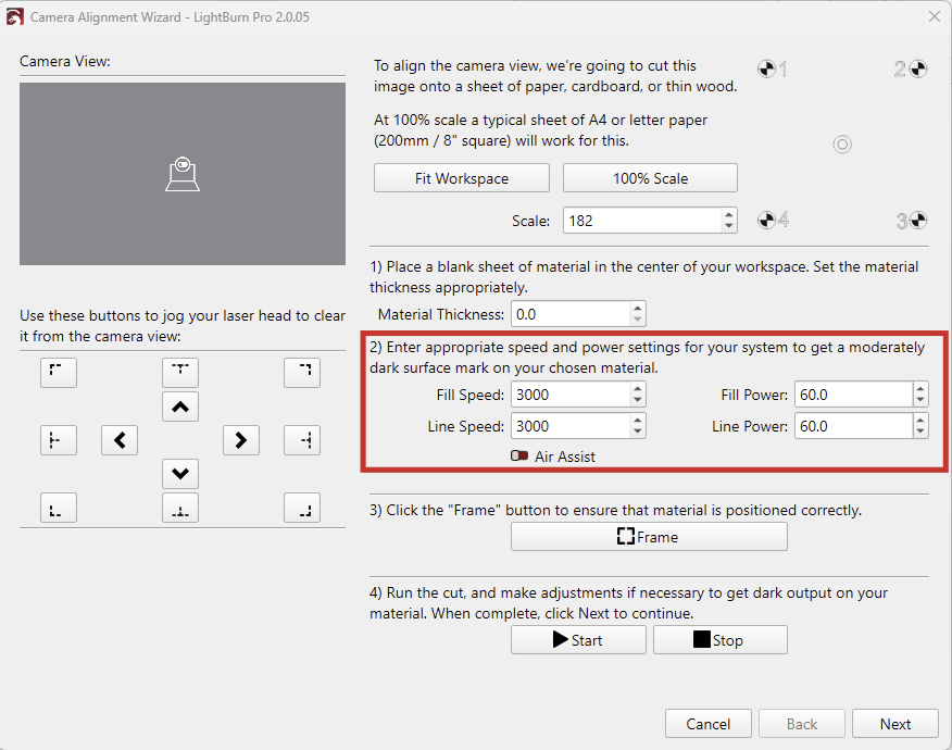

After this, you need to perform another Camera Alignment: Calibrate Camera Alignment - LightBurn Documentation
Lower the “Fill- and Line Power”, or increase the Speed here if the engraving is too strong

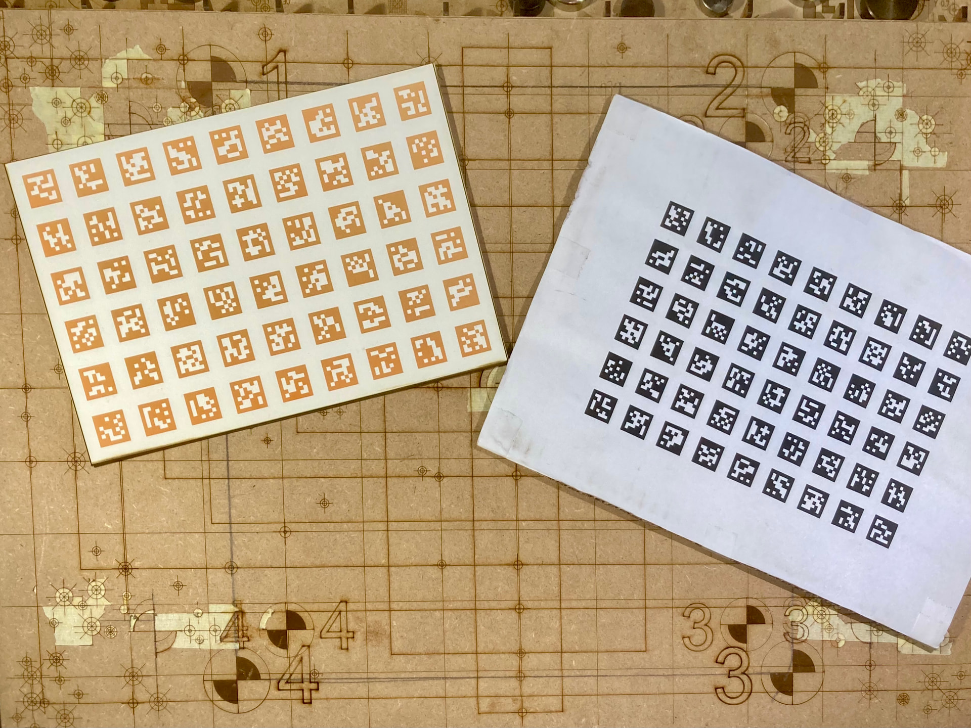

I would also recommend using the new calibration method from the latest LB version. I have downloaded and engraved lens calibration targets on a piece of 2-layer plastic, (it’s the reddish one) but have been using the same one for a long time just printed with a normal printer, btw. A4 is fine.

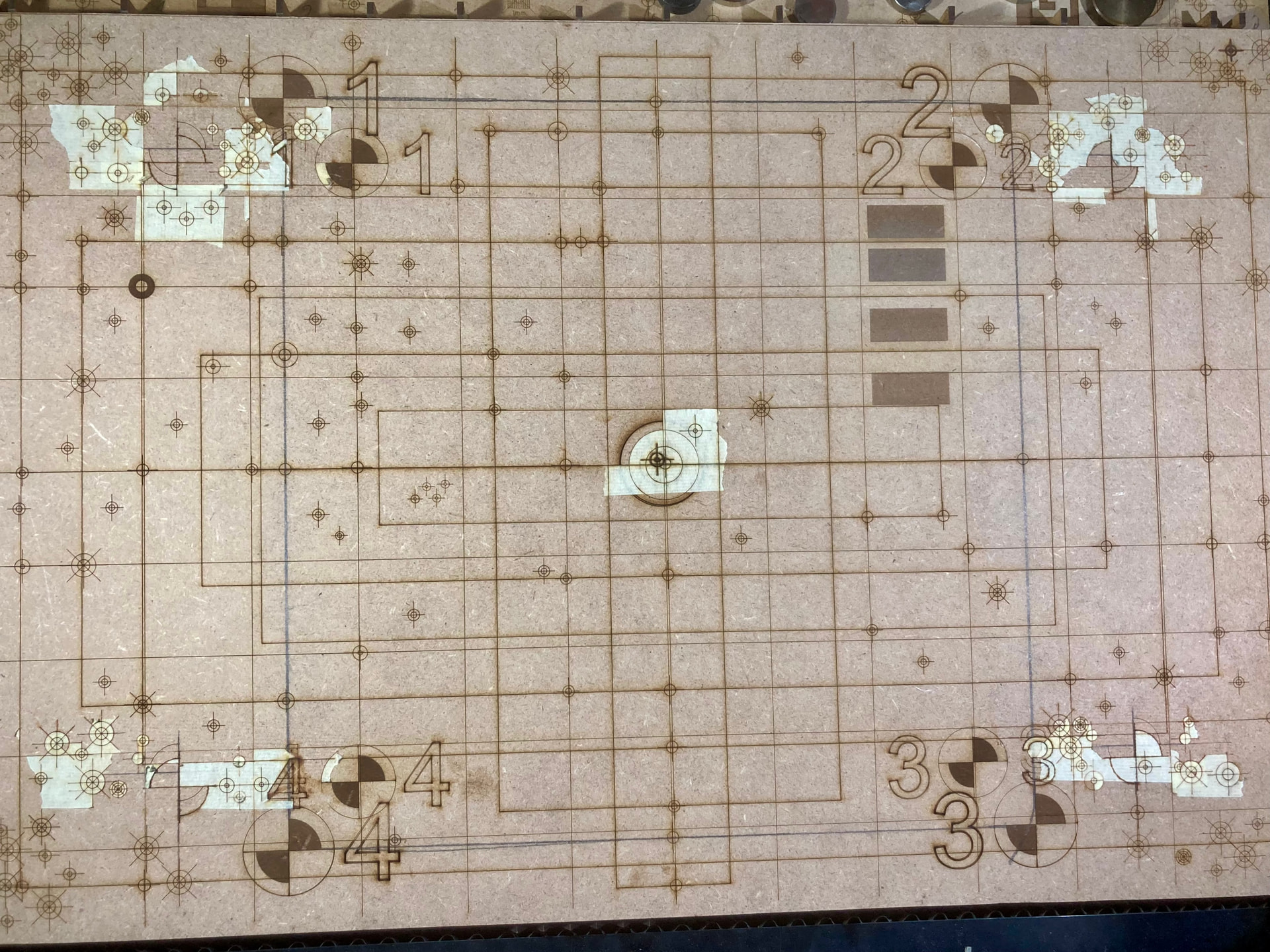

On average, I make 20 scans of the target plate, distributed over my entire machine bed, in different orientations.
Then I choose the profile with the best recognition value regardless of lens type.

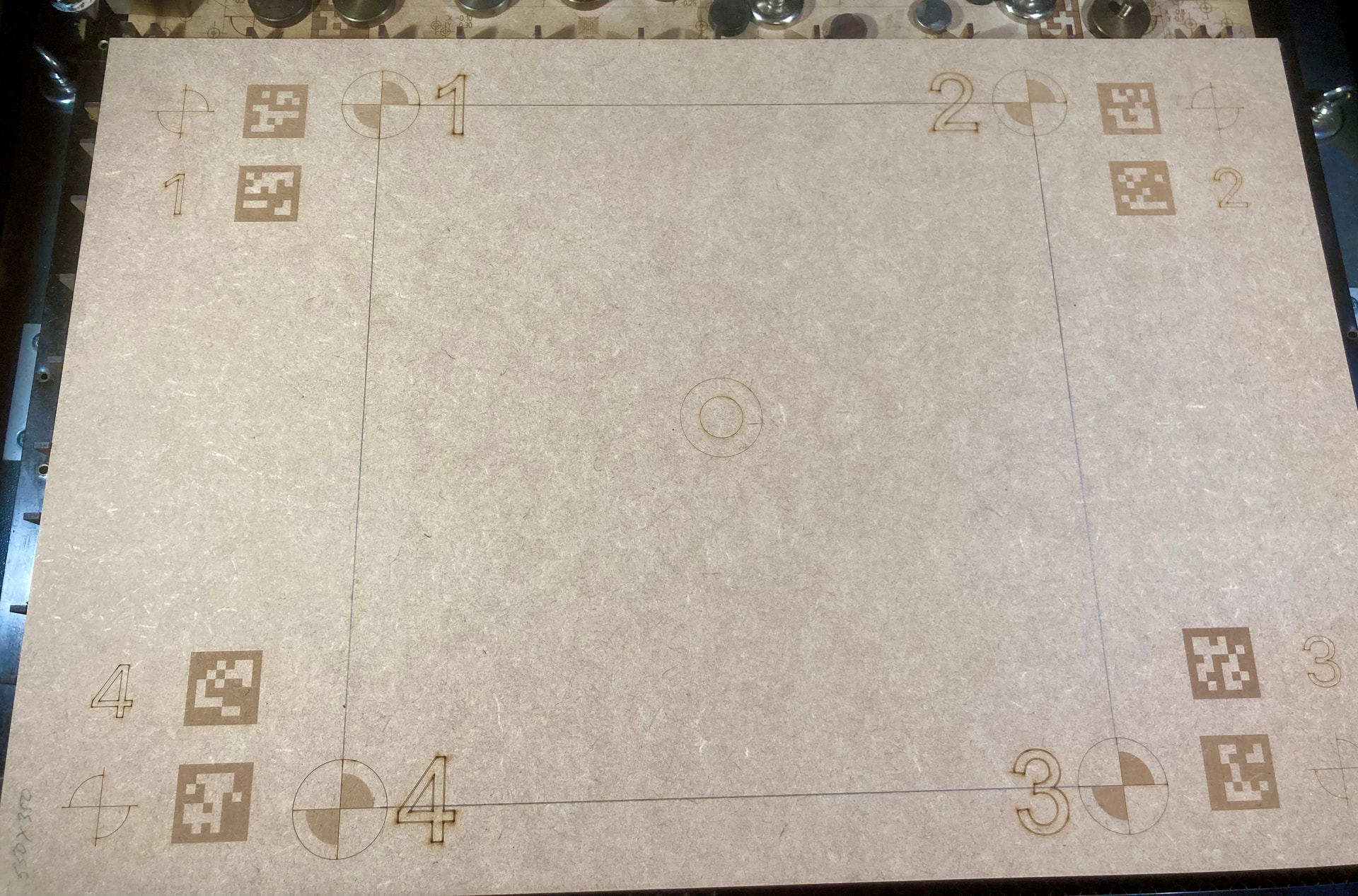

When the camera itself is to be calibrated, I again choose the “new” April Targets and correct the length and width so that it is printed with the largest possible distance from each other (350mmx550mm fits my machine, see picture)
Then I run camera alignment with April targets and save the result.

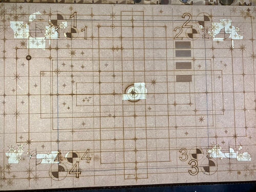

In the last picture there is a test plate that I use to fine-tune the results across the entire laser bed. If there are deviations of more than 1mm I start over again, with everything.

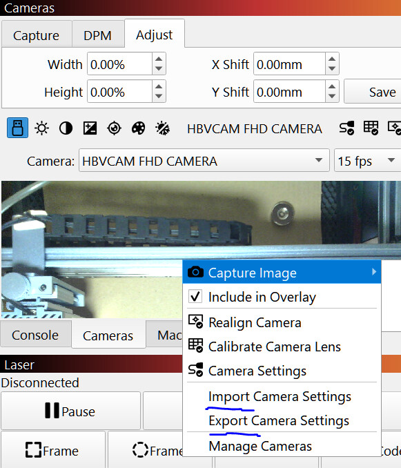

In the picture (nr.2) you can see that I have some physical stops on my X and Y axes, therefore I can “reuse” the camera alignment targets template.

For me it worked importing the camera settings from a previous 2.0.05 version maybe you can try the reverse, calibrate in 2.0.05 and then export/import to 1.7.08.
Wow now that is a big task for someone that is tech challenged :slight_smile:
If you right-click you can import and export
