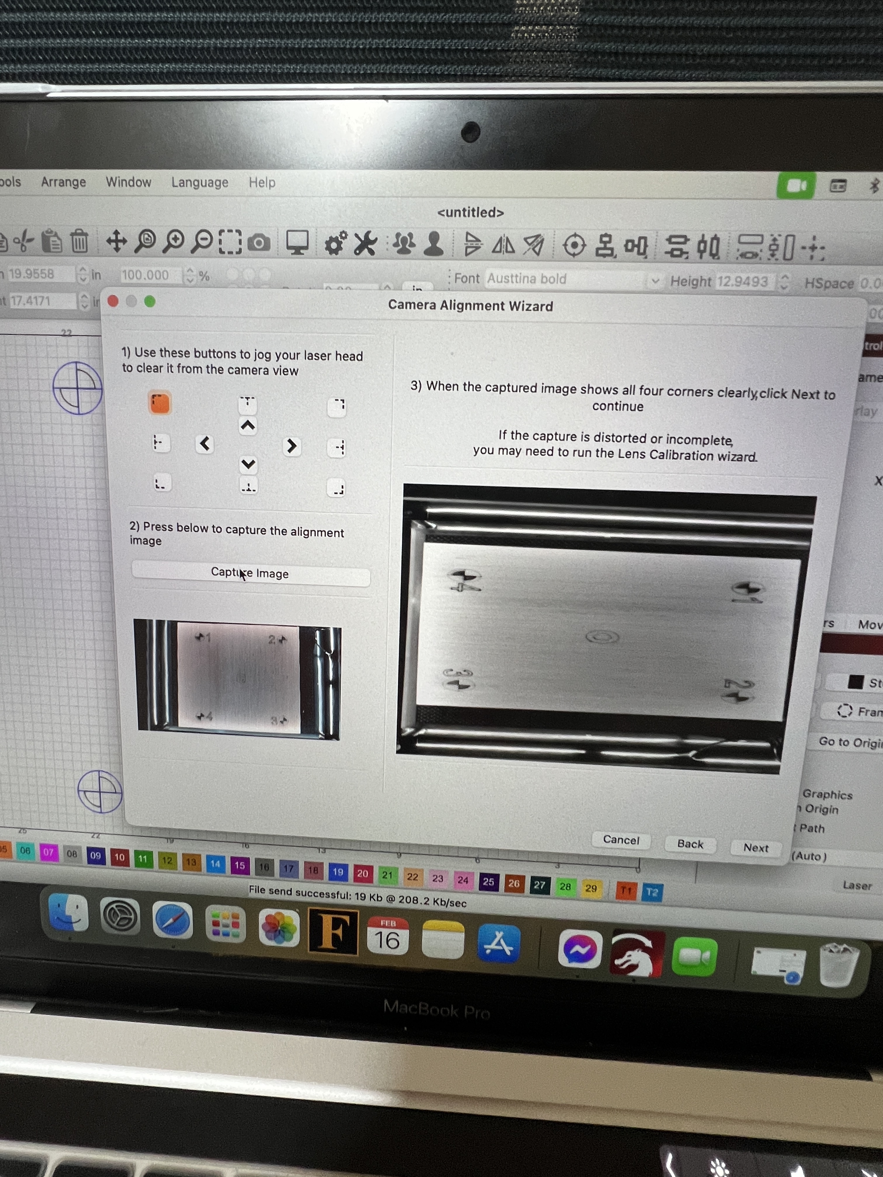

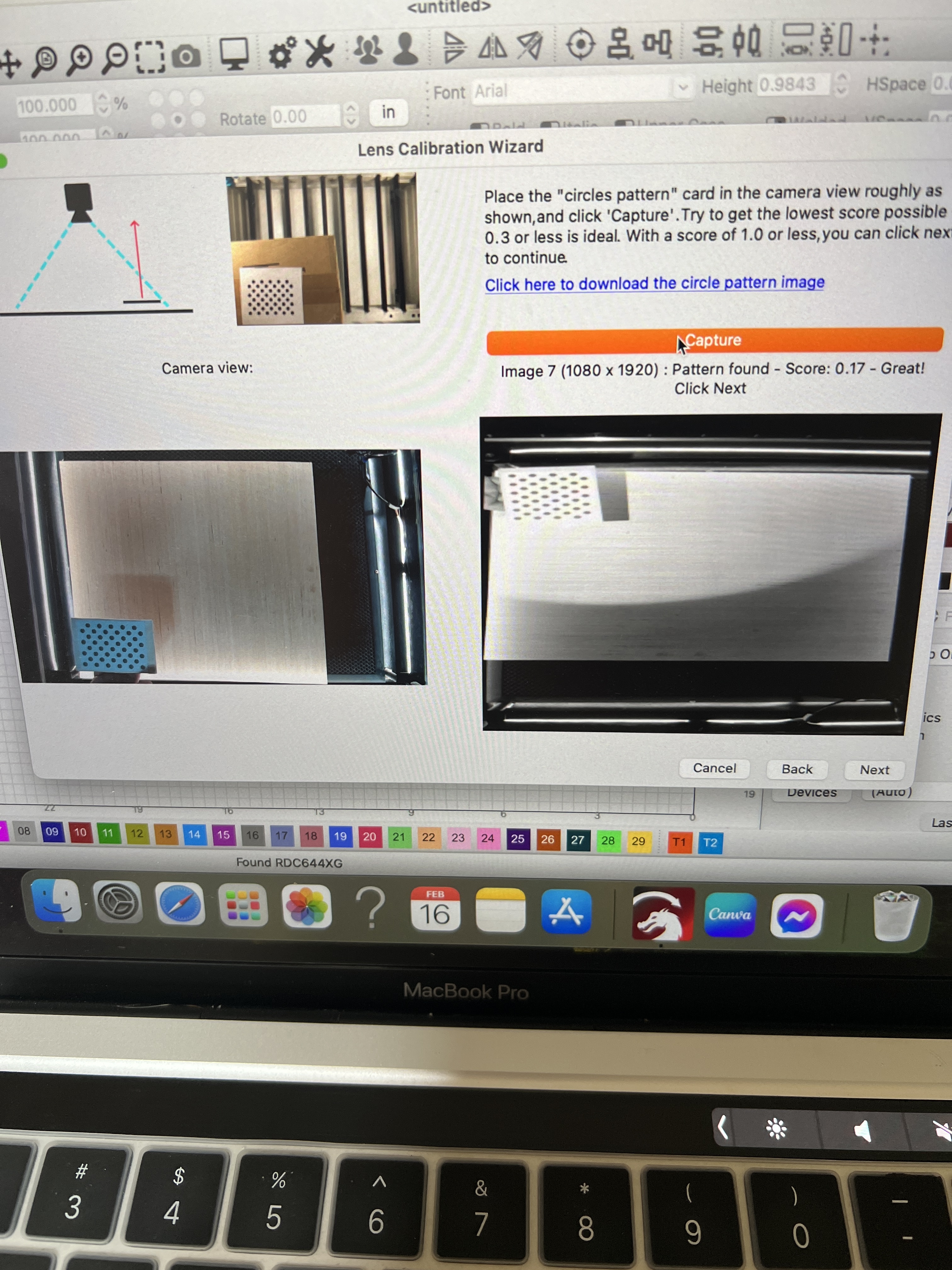

Trying to calibrate my camera using the lens calibration and camera alignment tools. My stuff is sideways in the captures. I did the engraving on the 1234 test but didn’t go forward because it was pretty blurry and sideways. Then I went to the lens calibration and stuff is sideways on there also. Any help to save my sanity would be greatly appreciated!

It does not matter if the camera is turned. Just do as the Wizard tells you.
Once you clicked the 4 points in alignment wizard in the correct order (start with 1 end with 4) LightBurn will rotate the image. Before, it does not know about the rotation.
