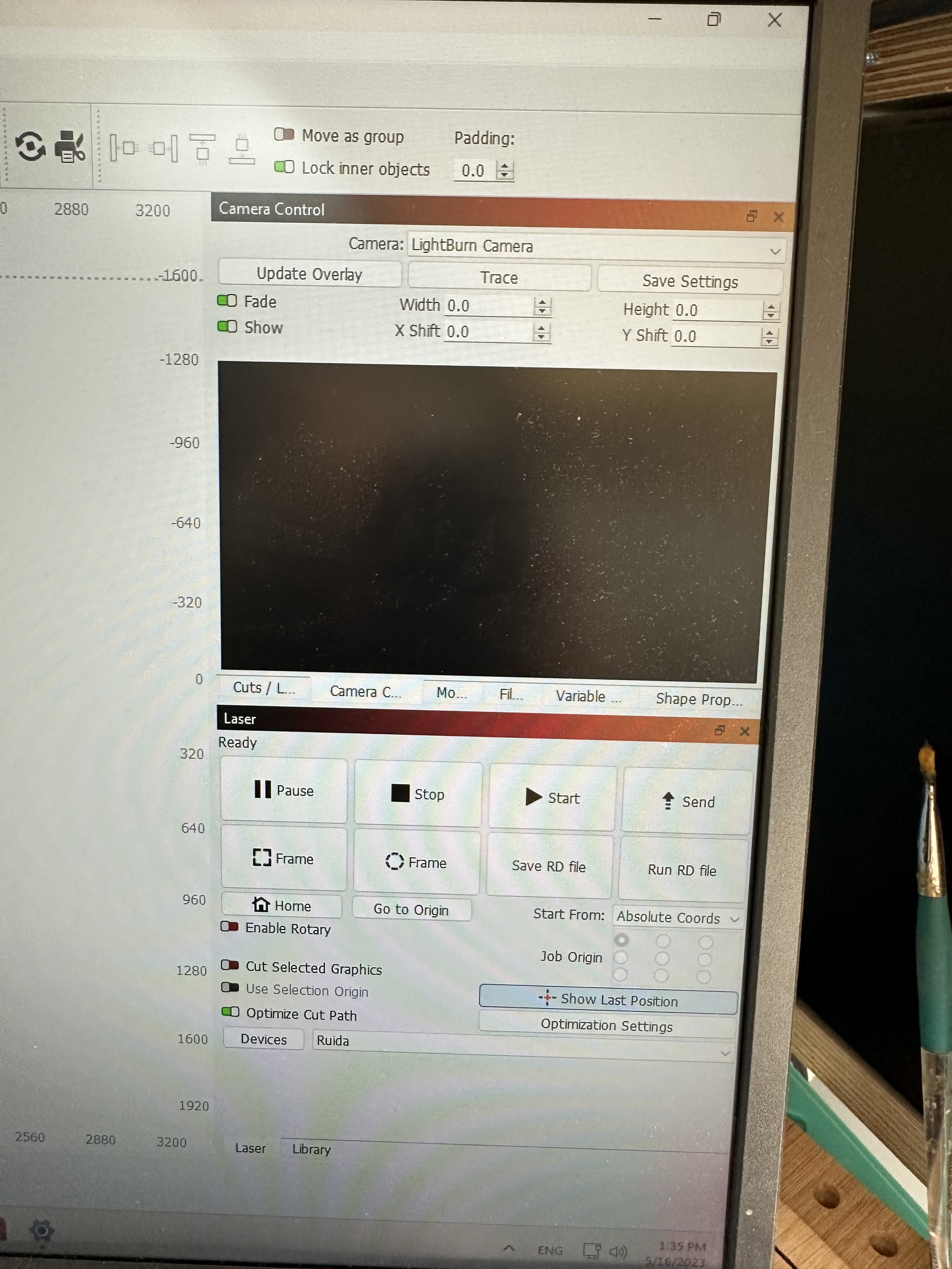

Hi,
I updated the software version and since the update the camera shut down and don’t provide any image.
USB cable plug and unplug, restart pc, connect and disconnect camera, camera driver…
Everything has been checked but nothing help.
I checked other topics but didn’t get any information about it
It always keep black photo… also when I take picture there is no photo appear and the button can be clicked once

Which software did you use to confirm that the camera is working?
Are there any other available devices listed under Camera in the Camera Control window?
Click Edit in the top row, click Settings, and select the alternative option for Camera capture system. It doesn’t always work but this may work.
This is a fairly comprehensive article about camera troubleshooting in Windows 11.
I used the windows camera settings and it give a live stream
The camera works fine in the windows camera settings view, when the software is open than the camera dissappear but still working. and in light burn it allways stay black screen at image box.
No only lightburn camera device is connected to camera list.
Yes, i tried Default and Custom in all the variation…
