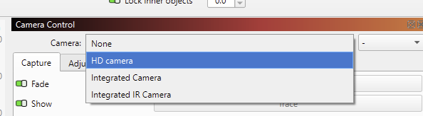

Just making sure: Does the camera appear on this list, and did you select it?

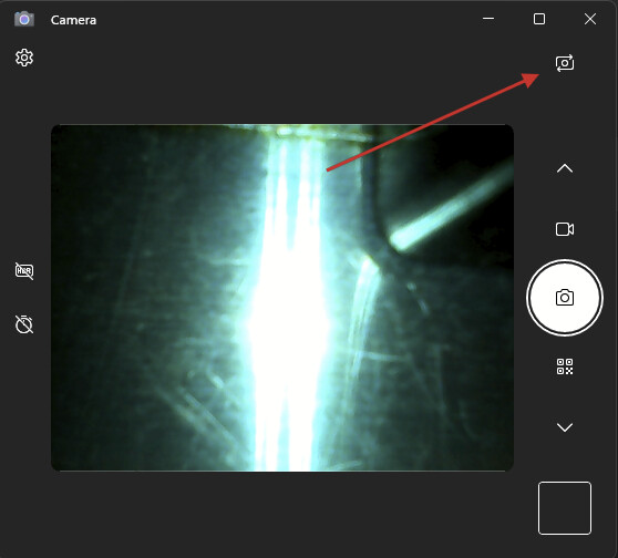

In order to rule out a defective camera, or cable can you try getting an image in the Windows Camera app?
Click on this icon to switch between the attached cameras:
