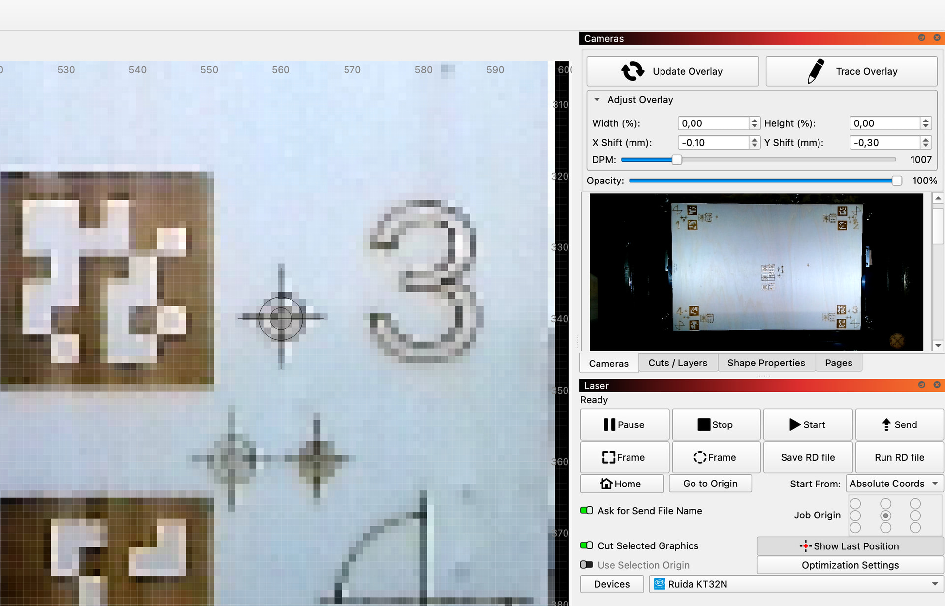

Well, I’ve spent countless hours online with Thunder Laser, who are trying hard to help me, to no avail. It sounds like Lightburn are speaking with them about this. Rolling back to a previous version of Lightburn does nothing.
It’s as if upgrading to 2.1.04 somehow permanently made my camera unusable. I’ve done a complete re-install of my laser from scratch, still can’t calibrate it properly. I’m wondering, would getting a Windows computer help the issue? I’m on a Macbook Pro now, but need to get this thing up and running again.
No, it won’t help with another OS. I run LB on Windows, Linux but mostly on my MBP’s - without the problems you describe.
With the deviation you describe it “must” be a problem with your workspace alignment. (I assume you have finally managed to calibrate your lens, there were also problems with that, if I remember correctly)

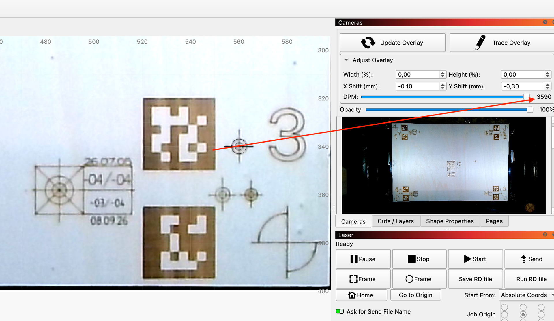

Regarding the pixelated images you mention in your other thread,…I mean I’ve asked before, but what is your DPM set to?
My DPM goes way down if I use the supplied calibration. It’s sitting at 1110 right now. If I roll back I get over 5000 DPM. I’m now at a point where the alignment is good, but DPM at 1000 so back to being pixelated.
DPM is of course camera dependent, but my standard LB camera is set to 3590 DPM, if I set it to 1000 I also get an almost useless image, that’s why I’m asking.
I get it; what’s happening in this case is if I calibrate the lens using the supplied factory calibration file, the DPM maxes out at 1100, but the alignment works great. If I try to do a new calibration, the max DPM goes above 5000, but the alignment is way off, even after either automatic or manual alignment.
Maybe you can open the settings files with an editor and change the max DPM accordingly.
