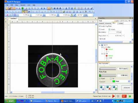

Do lightburn is capable to provide precise camera positioning? I assume it’s depend of camera quality, resolution. Rest is math and math is same everywhere. By precision I mean something like this:
I need to precise set laser unit over item and mark/cut it.
From my knowledlge, to achieve it, camera must be near laser module and software need to know distance between laser point and camera center. Of course after calibration (distance, angle, distortion etc).
Question is if lighburn is “ready” for this or I need to search other software?
If can then is possible to add in near updates custom camera overlay to make cross, lines etc on camera view? Like on provided video.

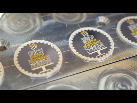

ps. It’s used in UV printers for precise printing on small objects.
Here is example of precise positioning for UV printing. It’s explain that is possible and how precise it can be (limited to step motors step):
You can use a head mounted camera in conjunction with the Print and Cut feature to pick up on fiducials - though I haven’t done anything with the head mounted camera system personally as of yet.
I saw video about it and it use head mounted camera. It’s not precise enought for my needs. Check attached video in my previous post. It explain what kind of precision I mean. It’s possible, but need to complete all things: good picture quality, resolution, stable mount point etc. Will order 8-16MPx camera for futher experiments.
