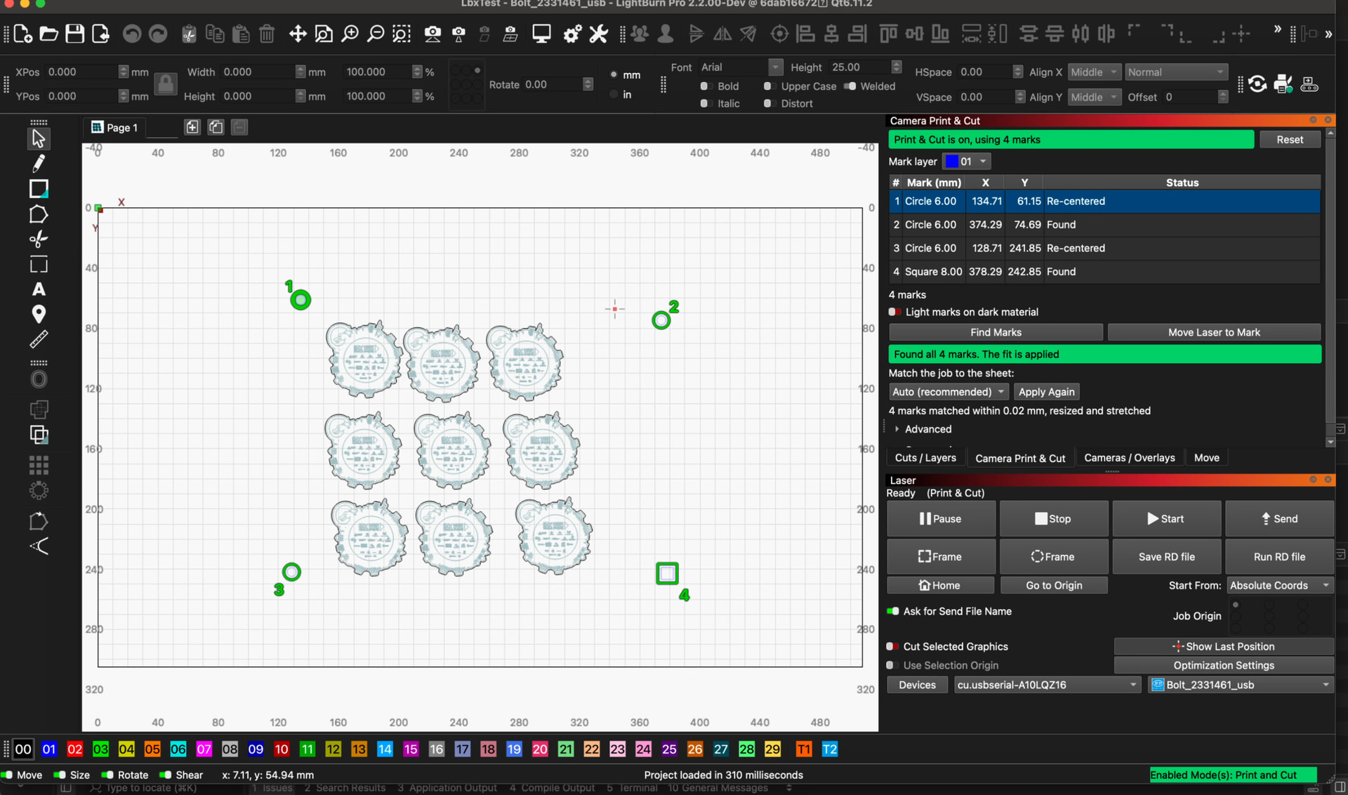

  6. When every mark is found, the fit is applied automatically, and the window says
    Found all 4 marks. The fit is applied.
  7. Optionally, check the fit: select a mark in the list and click Move Laser to Mark.
  8. Run your job as usual. It is moved onto the printed sheet.

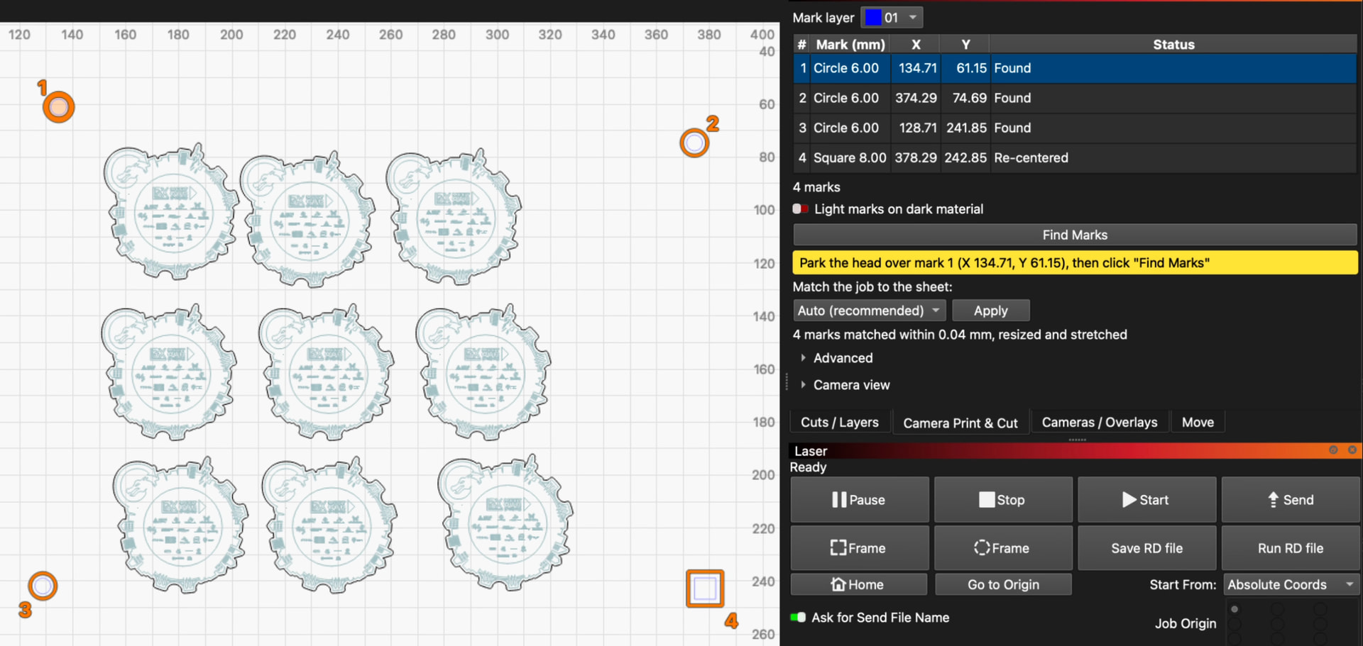

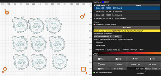

Before fit -
After search and Auto fit -

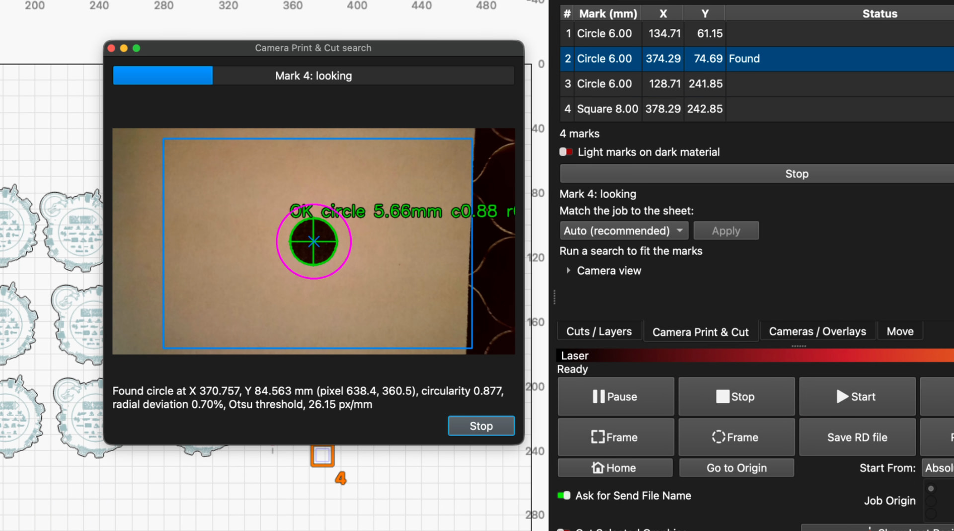

LightBurn searches around where it expects each mark. If it can’t find one, it stops and shows
Mark 3 not found. You can:
  • Jog the head near the missing mark, then click Search Here.
  • Click Skip to leave the mark out and carry on, as long as at least three marks remain.
Click Stop at any time to end the search.

Below it, a line tells you how closely the marks matched, for example
4 marks matched within 0.08 mm, resized evenly.

The fit is applied automatically when every mark is found and they all match. Otherwise, check the warning, then
click Apply to use the fit anyway.
While a fit is applied, a green bar at the top of the window says Print & Cut is on. Click Reset beside it
to turn Camera Print & Cut off.

Camera View
Click Camera view to see the last image the camera captured, with the mark it found outlined.
To check one mark without moving the head, select it in the list, jog the head so the camera can see it, and click
Find Mark in View. The line below the image says where the mark was found and how big it is.
