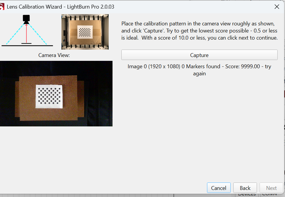

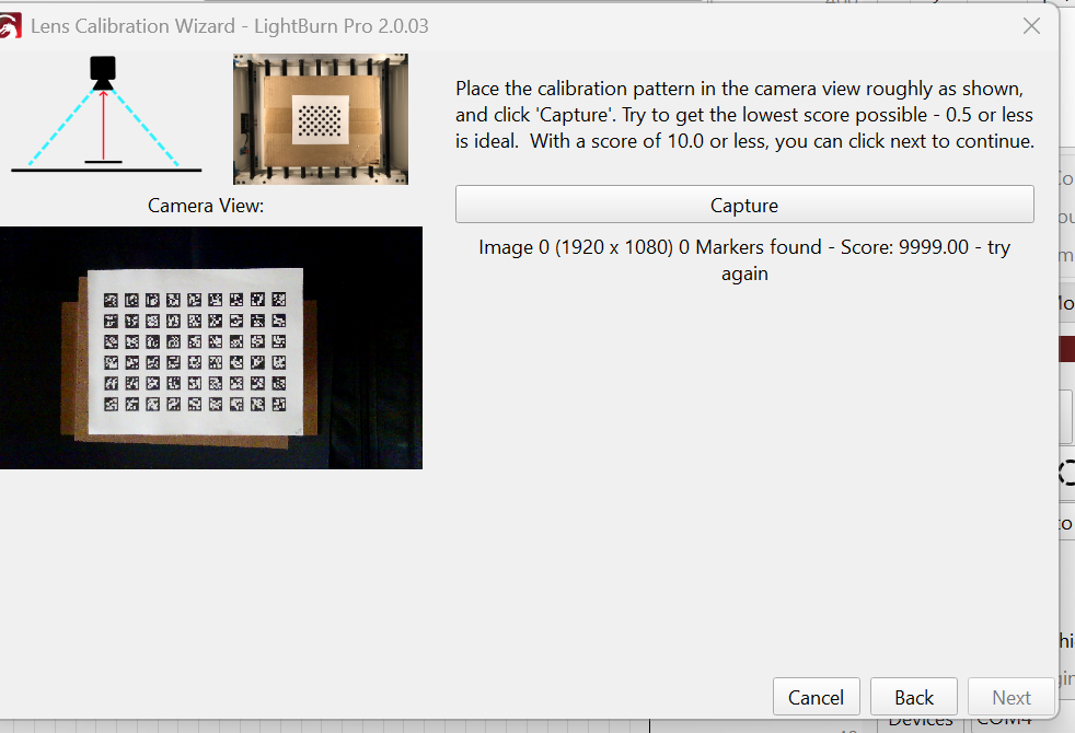

I’ve read just about everything I can find in the forums but still can’t get camera calibration to find the markers. As in the images below you’ll see I get a 0 Markers Found result no matter what I try.
This is a generic USB camera (showing flipped left/right on screen) mounted directly above the laser. Just to try and get a successful calibration shot, not being concerned with actual table location for now, I’ve put the pattern on top of a box sitting on the laser shroud. This gives me the 1/9 image coverage on the dotted pattern.
Both patterns shown are downloaded recently from the Lightburn website.
I’ve tried both regular and fisheye lens settings with the same results.
Can someone tell me what I’m missing?
Thanks,
BH

Thanks. Moved the camera closer but same results.
BH

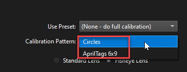

Did you select the appropriate calibration pattern before you started the process?:
When using the AprilTags pattern try using the newer wizard:
Right-click in Camera Control window and select Calibrate Camera Lens with Tag Tracking (Labs)
No, did not select circles. Both tries were done with the AprilTags 6x9. That you for point that out. I’ll give it a try with the circles and report back.
If that doesn’t do it I’ll try:
Right-click in Camera Control window and select **Calibrate Camera Lens with Tag Tracking (Labs)

THANK YOU !!!
I hadn’t noticed the CIRCLES option and once I selected it and put the camera within 10" of the plate that did the trick.
