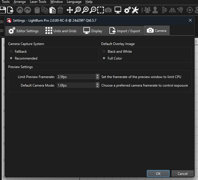

I run 3 cameras in my laser. Basic USB style, all 5mp or better. All the cams had decent image quality before the 2.0 updates. But now the framerates are super low. I’ve tried adjusting the framerates up and down with little improvement. One of the cams is running at around 4 frames per minute. All the cams run great if I use the Windows camera app outside of LB.

Cameras now default to low FPS to keep CPU overhead low. You can change the default FPS from the Camera tab under ‘Edit > Settings’
I’ve adjusted the FPS setting through the entire range. Minor improvement with everything maxed.

Camera framerate is lowered to reduce CPU overhead - cameras take a lot of processing power. The framerate is now selectable in LightBurn if you wish to bump it up: Camera Control Window - LightBurn Documentation
On the right side of the camera control panel

Hi there, sorry I’ve taken so long. I’ve checked in every now and again but did not have any better theories than the support crew, and I’m just as confused. I’ve never had a USB connected camera with a framerate as low as you’ve described. I’ve seen some drop down to 0.5fps in low-light conditions as they try to adjust exposure to match, but 5 frames a minute means 20 seconds per frame…
I’m not even sure it’s possible to enter in fractional FPS’s that low (0.05fps) and I doubt you’ve have missed that.
You are correct that it doesn’t have anything to do with calibration or alignment. Those systems aren’t involved with the preview. I doubt the bottleneck is your CPU otherwise you’d be complaining the app UI was slow (because the preview would be using all your processor power).
There doesn’t seem to be any reason for it, and to my knowledge we’ve never had any else complain about an FPS so low. (one person complained about the default 2fps limit instead of the 30fps they were used to…)
I have one suggested thing to try, and if that fails one possible way forward.
In the LightBurn Settings window, in the Camera tab, try the “Fallback” capture system instead of “Recommended”. That will use an older set of camera drivers that typically has worse performance, but may be more compatible.
If that fails, could you create a debug log which contains the camera startup sequence? (I think it’s ‘enable debug log’ then right-click on the ‘Devices’ button to reconnect the laser/cameras and log about it. But support can walk you through that) We’re looking for the “VISION:” block that lists all the camera resolutions.
We could also use a little more information about the camera you have, and your exact version of Windows 10. Are you at least running the “Windows 10 Anniversary Update” version or later? (aka version 1607) There were significant updates to the Win10 camera system API after that. If you are running a very early version of Windows 10 that could explain it.
