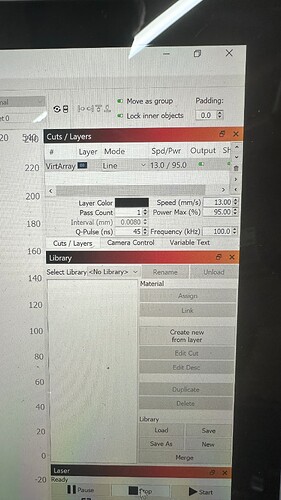

This wood ‘browns’ just fine if i put a flame to it, but the laser just wants to evaporate it in a ball of flames.
This setting kinda-worked for making a small square (no fill), but it wouldn’t work for text or filled squares.

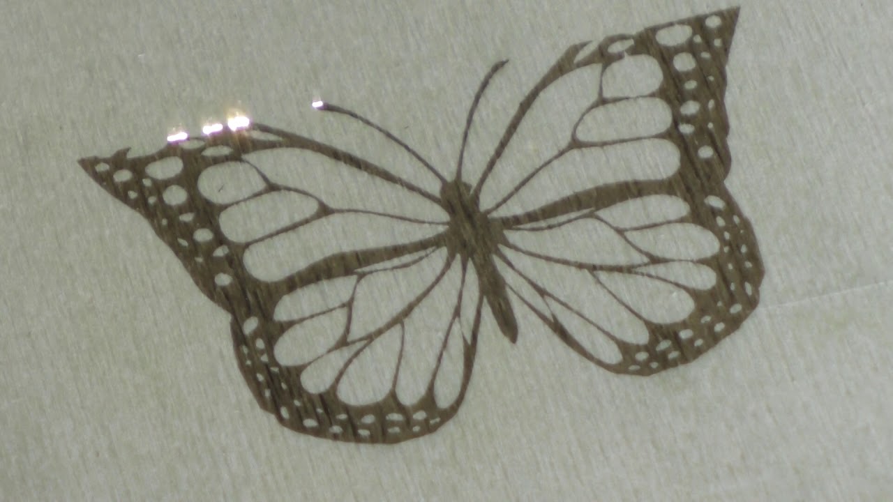

I think you are correct as it kinda-works .

If you paint a wood it is possible to deep engrave. Some types of wood can engrave directly. Like walnut, rosewood.
