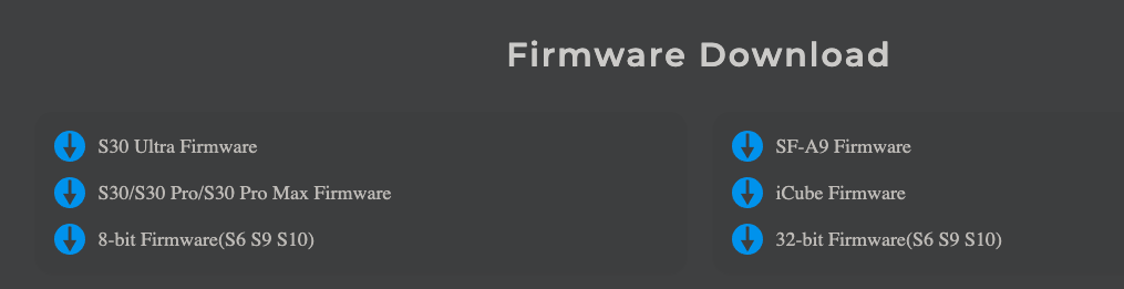

Here’s where Sculpfun has provided their firmware: SCULPFUN Support – Sculpfun.

Flashing the wrong firmware is not dramatic, you can flash a new one again. Since S9 mainboards are not produced any more (the laser is outdated since 2021), newer devices are sold with the mainboards that are available at that moment. Try the S6 S9 S10 version first, then S30 version. After flashing, reset the controller by sending $RST=* first.
Wish I’d have seen your comment before installing the switches, Sculpfun need to update the instructions. I took your advice and installed the S30 FW and that did the trick, all working well now. Thanks :slight_smile:
