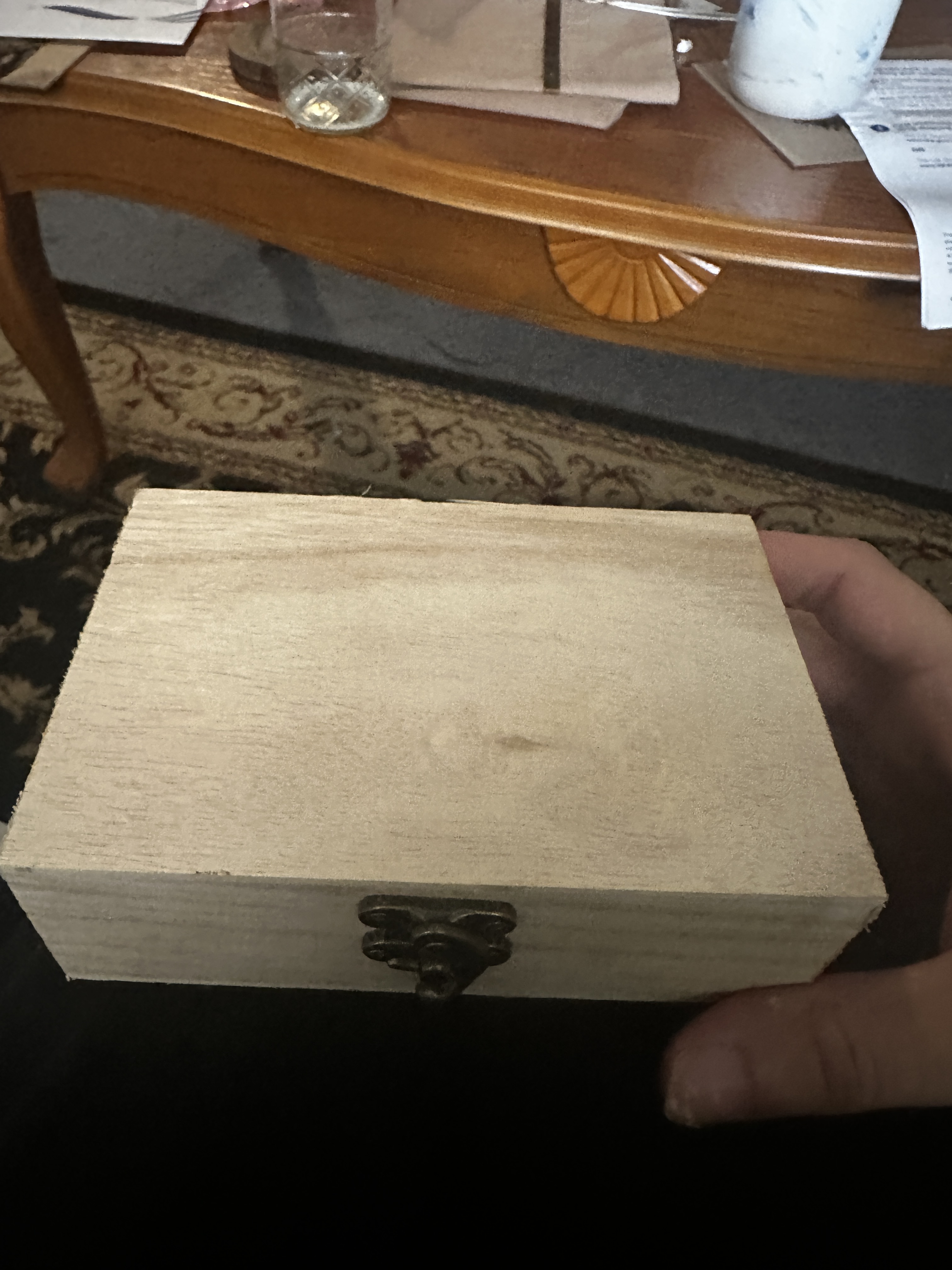

Can i have a layer for text then a separate layer for say a graphic and it engrave
What im trying to do is engrave scripture on this
The width is 148x98 i believe

Suggest you use some of that material as a test bed to explore the proper settings for what you wish to do…
It takes more power to do a sliced tree branch from my back yard than it does to do an mdf basswood… You need to use the materials test on your scrap pieces…
Good luck
Why not ![]()
If you can get your fine box under your laser nozzle with the right focus distance, you can engrave or cut what you want, with all the layers you need. I do this kind of job once in a while with similar parts to order. It is important to have a template or some other form of reference for your X and Y axis.
