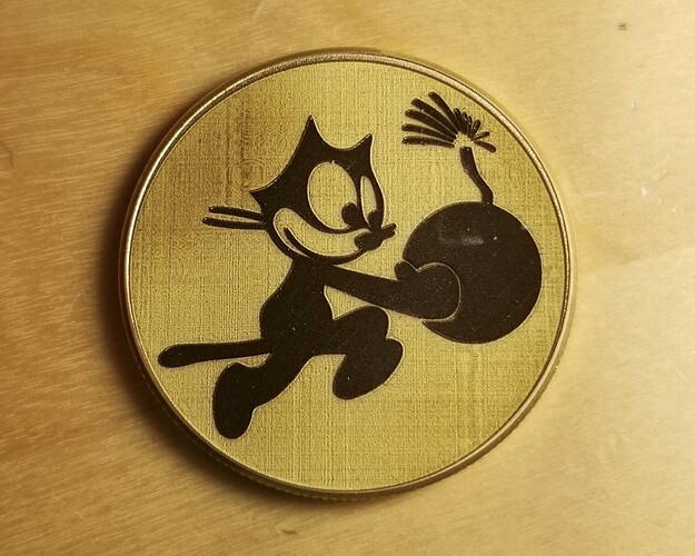

Something like these should be possible…
Don’t forget you can also anneal/oxidize it with/without engraving… it was engraved for depth, then another layer annealed/oxidized it black.
Good luck…
And it takes some time. Felix looks pretty flat but I bet the USA coin took a few hours.

All of them took over 2 hours each… such is life… there are some changes I made to speed things up, but it still takes lots of time to remove that much material… boring to sit there and watch the same thing over and over…
If I try to get more material out per pass, it seems to leave the brass with discoloration…

From the photo, I agree, but it was engraved pretty well then I did a pass to blacken the unengraved area. Viewing angle makes in look rather deceiving from reality. You can easily feel it.
I’ve never found a good cleanup pass for these coins… if you know of one, pleas let me know…
I’ve dropped the power increased the frequency, interval and q-pulse… Never comes out shiny.

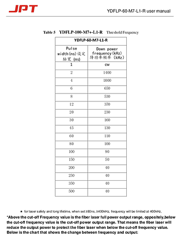

I had a couple questions about what the specification state and what my JPT MOPA will actually do…
This says adjustable frequency range is 40 - 4000 kHz…
Which conflicts with the next page…
which is supported by this graphic… mostly, but there are a couple, like the 13nS…
Here is the manual if you want to look yourself… maybe you can figure out what they mean…
JPT YDFLP-60-M7-L1-R User Manual-20191202.pdf.txt (1.2 MB)
I’ve looked that over, I have same or similar. zoom in and “Adjustable says 1-4000”, and the line above that says “Full” full power 40-4000, both specs agree with the threshold frequency chart. Full power from 200-500 pulse from 40KHZ
Anything shorter then 200 pulse the frequency needs to go up to achieve full power. I’m no expert but that’s how I read it.
I’m not smart enough to fully get the 3rd chart, but it appears to show the peak of the pulse no where near the center of the pulse by varying degrees except around the 80ns mark, but I’ve a bit of a color handicap so not quite sure. Do you think 0 on the t/ns scale is also the peak of the frequency waveform? Or is the peak of the pulse the center of the frequency waveform?
