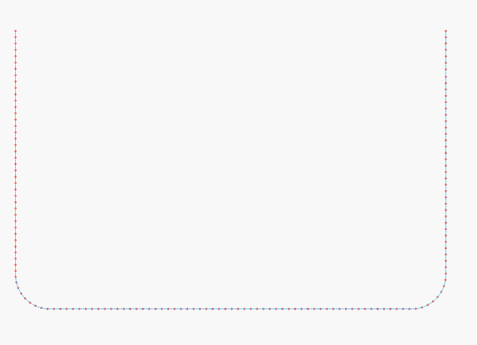

I have this line created in lightburn thats only a tool line with holes that I cut in this form, I would like to use the same holes on a straight connecting piece, how can I straighten this entire thing keeping the red hole lines where they are on the line? is this possible? TIA

Hi Neil, Yes it is what I did with this one, but its stitching holes, so need to be exactly the same, I did move some around to make it work better, so the connecting piece needs to have the exact same holes. That’s why I thought it would be better to just straighten these.

Hi Jim, please find attached. If you find a viable solution please do share it as I do these designs quite a bit and always spend way too long to get the exact holes on both pieces. Thank you.

@johanbosman, Take a look at this, I had to change it afew mm in places now all holes are at 5mm centers. if this will work for you I will show you the fastest way to do it later.
