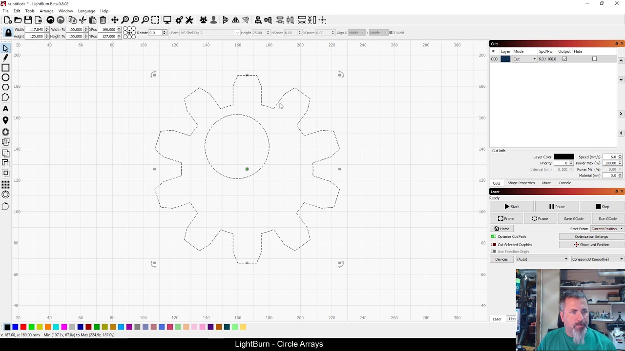

You don’t say how you manually created your circles. The polar array tool is perfect for making the designs you’ve presented. Click on the line, then shift-click on either outside circle, then select the polar array tool. Make the settings as desired. It’s a great utility with a live/dynamic display.
I made a circle 100 mm in diameter, drew a line 50 mm long, set the origin to center. Then I manually placed the line in the circle, copy and rotate 120° two times and I had three pieces ![]()
But thanks for the hint, I found a video that helped now, it’s actually easy.

Hi Merlin, sure the video I looked at was this one:
I hope it helps, if you have any questions don’t hesitate to ask. ![]()
