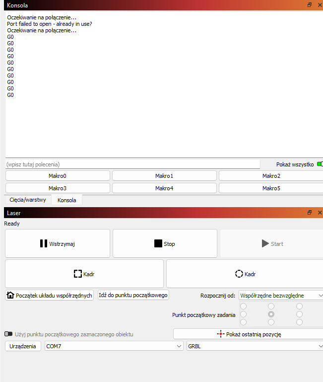

Hello,
I am trying to connect my Sculpfun s30 pro with LightBurn (the latest version) but without succes. The software can not find the laser and when i add it manually it shows “Ready” but the laser does not respond for G0.
I checked Lasergrbl software to be sure it’s not some hardware problem but the laser connected without any problems and it works well with those software.
I would appreciate any help because Lightburn seems to be much more user friendly so it would be great to try it.
First thing is to try to toggle the “enable DTR signal” option in device settings. Does it help?
Thank you ! Yes it did
