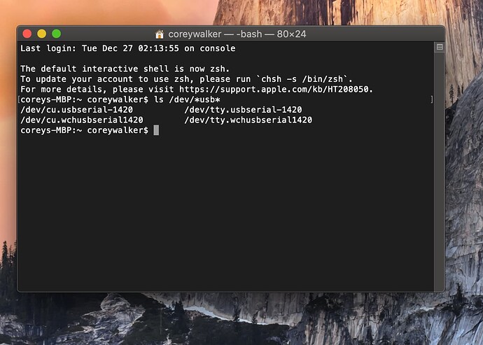

Can not connect to my laser

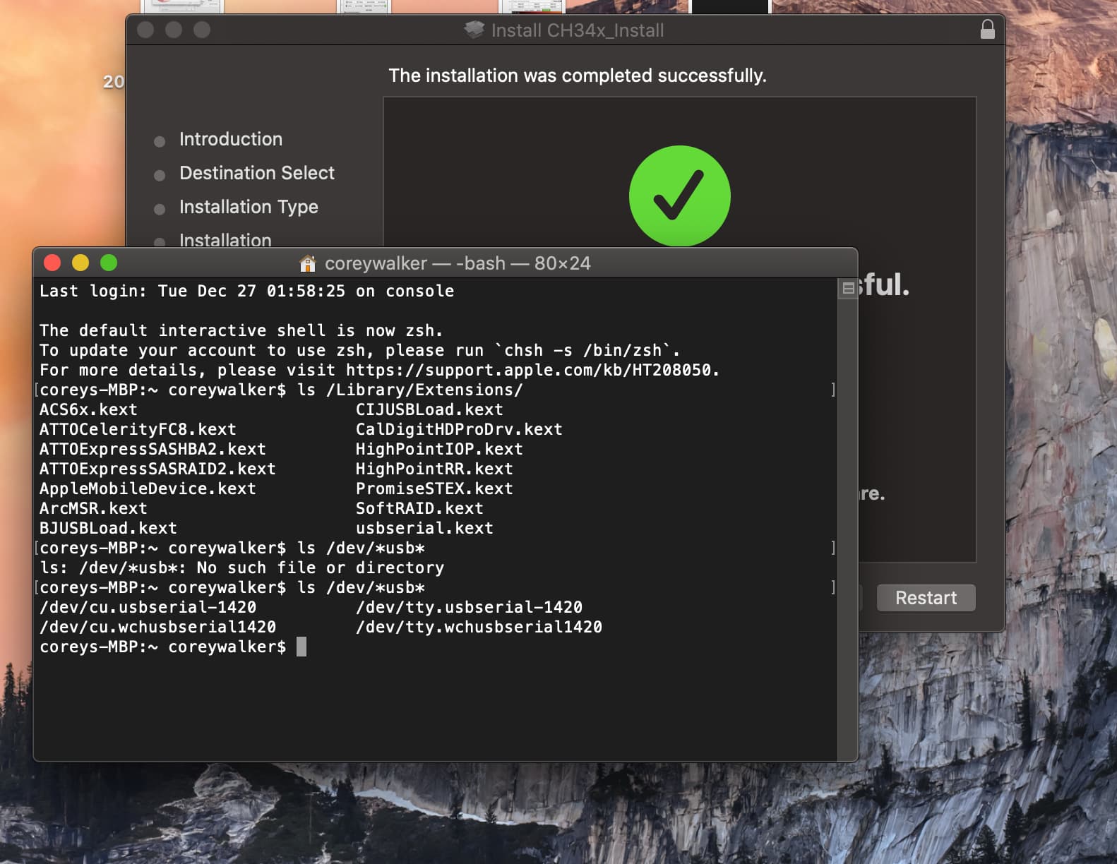

the first two pictures are from me manually removing and loading the drivers then checking to see if the device shows.

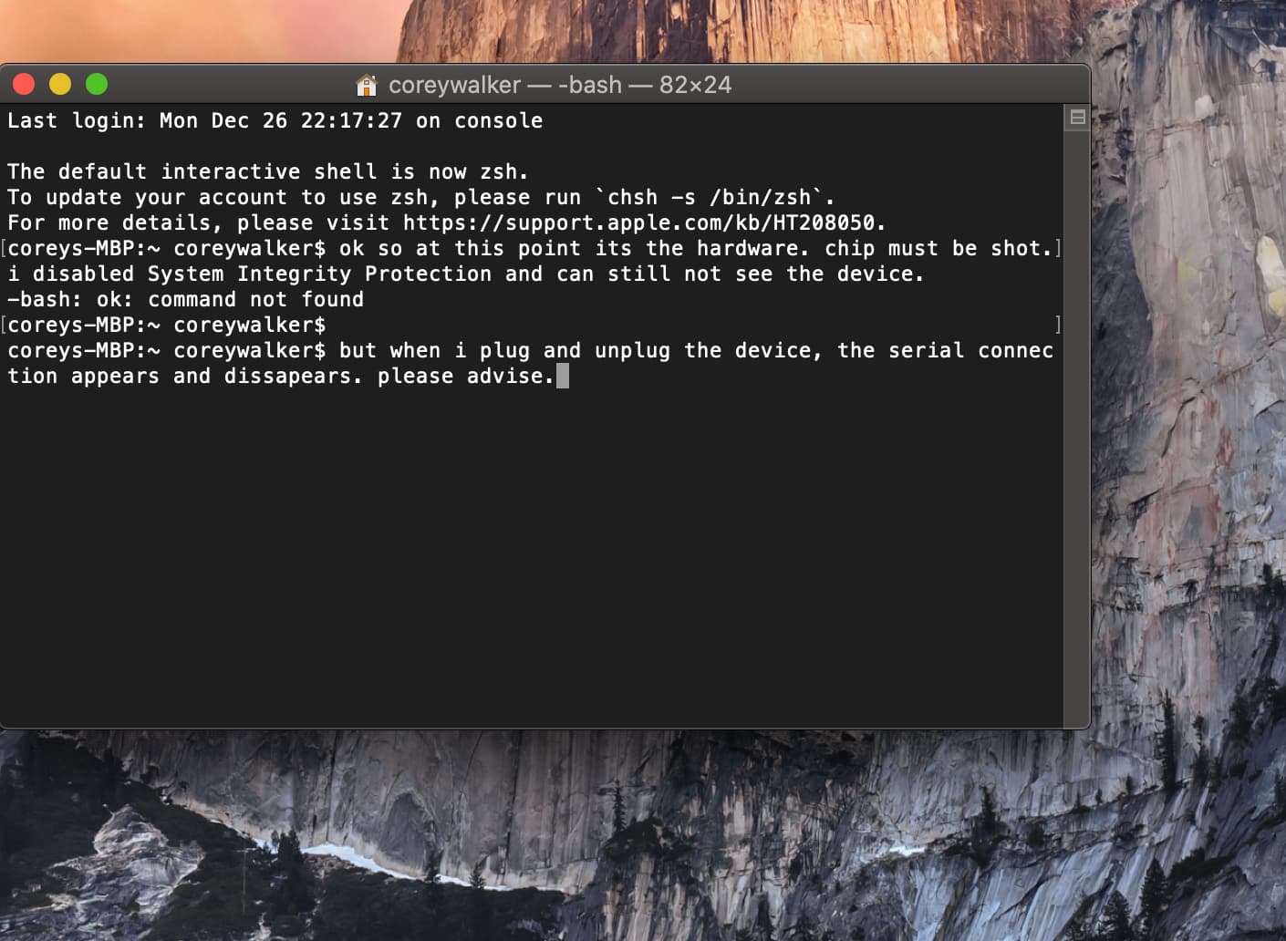

the last picture is right after i did the steps you explained

It’s unclear where you stand or what you’re attempting to do. Did you attempt the steps I listed in the last post? If so, what was the result?
I see you’re trying to provide some information in the screenshots but it’s unclear what the order is of the screenshots or what you’re trying to convey overall as there’s no context.
im sorry for the new topic but it was telling me i had reached my limit of replies to the topic

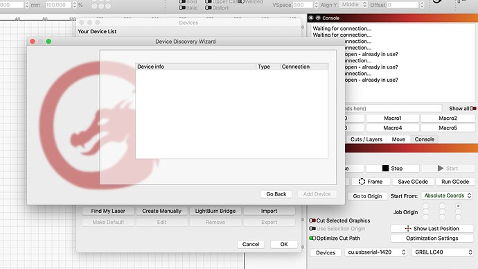

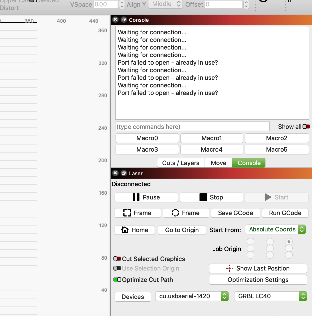

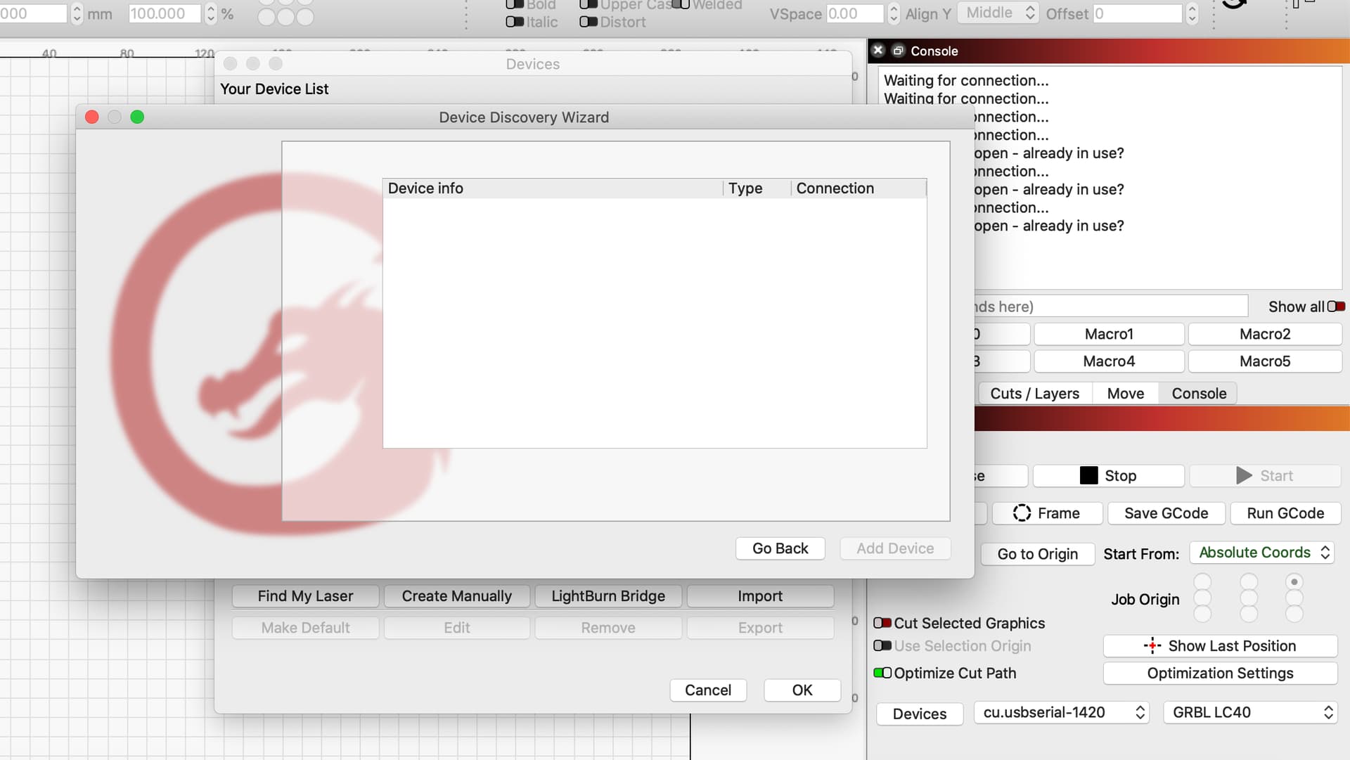

i did everything you suggested
the results where the program could not connect to the laser
I want to confirm.
You ran these commands?

You then reinstalled the CH340 linked from this site?
CH340 Drivers for Windows, Mac and Linux (gogo.co.nz)
Did you double-click on the CH34x_Install_V1.5.pkg file to install it?
Can you run these commands in Terminal and return output?
ls /Library/Extensions
ls /System/Library/Extensions
ls /dev/*usb*

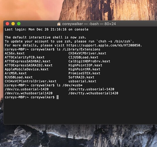

yes i ran the commands
Last login: Tue Dec 27 01:20:18 on ttys000
The default interactive shell is now zsh.
To update your account to use zsh, please run chsh -s /bin/zsh.
For more details, please visit Use zsh as the default shell on your Mac - Apple Support.
coreys-MBP:~ coreywalker$ ls /Library/Extensions
ACS6x.kext CH34xVCPDriver.kext
ATTOCelerityFC8.kext CIJUSBLoad.kext
ATTOExpressSASHBA2.kext CalDigitHDProDrv.kext
ATTOExpressSASRAID2.kext HighPointIOP.kext
AppleMobileDevice.kext HighPointRR.kext
ArcMSR.kext PromiseSTEX.kext
BJUSBLoad.kext SoftRAID.kext
CH34xVCPControlDriver.kext usbserial.kext

coreys-MBP:~ coreywalker$ ls /dev/usb
/dev/cu.usbserial-1420 /dev/cu.wchusbserial1420 /dev/tty.usbserial-1420 /dev/tty.wchusbserial1420
and yes i doubble clicked to install it
I see what’s going on. I made a typo in the commands. Can you do one step at a time?
Run this in Terminal:
sudo rm -R /Library/Extensions/CH34xVCPControlDriver.kext
sudo rm -R /Library/Extensions/CH34xVCPDriver.kext

coreys-MBP:~ coreywalker$ sudo rm -R /Library/Extensions/CH34xVCPControlDriver.kext
Password:
rm: /Library/Extensions/CH34xVCPControlDriver.kext: No such file or directory
coreys-MBP:~ coreywalker$ sudo rm -R /Library/Extensions/CH34xVCPDriver.kext
coreys-MBP:~ coreywalker$ sudo rm -R /Library/Extensions/usbserial.kext
coreys-MBP:~ coreywalker$ sudo rm -R /var/db/receipts/com.wch.ch34xinstall.mykextdir.pkg.bom
coreys-MBP:~ coreywalker$ sudo rm -R /var/db/receipts/com.wch.ch34xinstall.mykextdir.pkg.plist
coreys-MBP:~ coreywalker$ sudo rm -R /var/db/receipts/cn.wch.pkg.CH34xVCPDriver.bom
rm: /var/db/receipts/cn.wch.pkg.CH34xVCPDriver.bom: No such file or directory
coreys-MBP:~ coreywalker$ sudo rm -R /var/db/receipts/cn.wch.pkg.CH34xVCPDriver.plist
rm: /var/db/receipts/cn.wch.pkg.CH34xVCPDriver.plist: No such file or directory
ACS6x.kext ArcMSR.kext HighPointRR.kext
ATTOCelerityFC8.kext BJUSBLoad.kext PromiseSTEX.kext
ATTOExpressSASHBA2.kext CIJUSBLoad.kext SoftRAID.kext
ATTOExpressSASRAID2.kext CalDigitHDProDrv.kext
AppleMobileDevice.kext HighPointIOP.kext

No. It won’t work at the moment because you have no drivers available.
Can you now reboot your computer? Following that, install the .pkg file for the driver.
Then run in Terminal and return output:
ls /Library/Extensions/
ls /dev/*usb*
force quit the installer or reboot?
Rebooting will be simpler.
Can you rerun this command after rebooting?
ls /dev/*usb*
just to confirm: the last two command inputs was machine off and then machine on (you probably know) im just trying to cover everything. and yes, i will run that command after rebooting. would you like the laser on or off while running the command after rebooting, or does it matter?
Yes. That’s fine.
On please.
Hmm… that’s not what I was hoping for as you still have two sets of devices.
Can you go ahead and test LightBurn? Try with both sets of ports. Set baud rate to 115,200.
