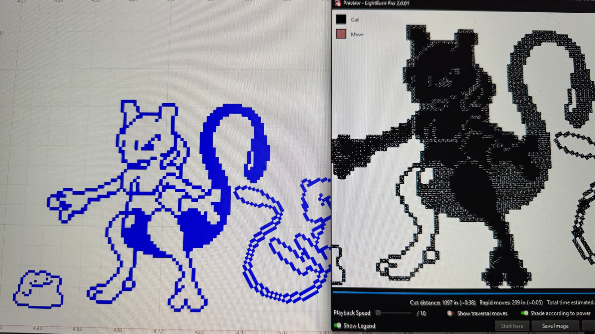

Can someone explain what is causing this?
I’m not sure when this started happening? But it’s not a double layer or anything. Anyone else with this issue?
How about double lines in the same layer?
+1
Delete duplicates under the EDIT menu.
