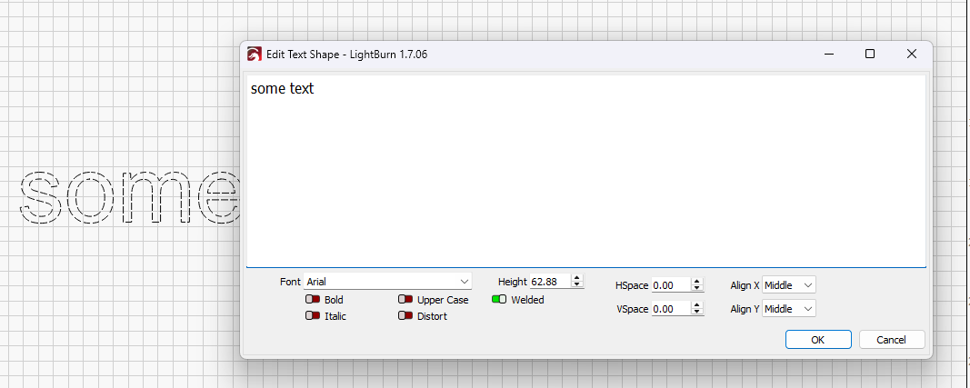

It stays as text unless you convert it to a path.
Double-click the text, do you get an ‘Edit Text Shape’ dialogue pop up?
LightBurn does not have the ability to recognize paths and convert them to a Text object, which would allow the font (and other font settings) to be changed.

No, I do not get that pop up dialogue box. The selected text (in this case it is just each individual letter since they are not grouped as a word) just turns to a “moving” segmented letter.
Ok, it’s either the result of tracing a bitmap or it originated as text and then converted to a path. Where did the original come from? Do you have an original you could post here?
